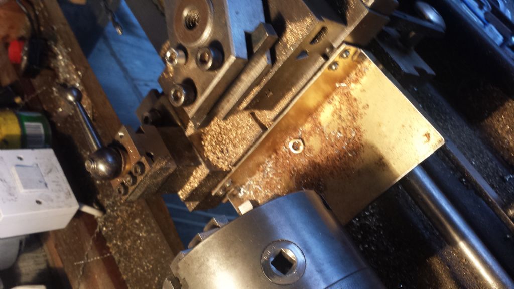

geoff walker 108/09/2017 14:26:19
521 forum posts
217 photos
Hi Ega,
I use this swarf tray to catch parted material. It was a readers tip some years ago in MEW, can't remember the issue number.
Two lugs on the tray slide into the cross slide tee slots, so easy to fit and remove. sorry about the angle of the picture. geoffswarf tray
Edited By Neil Wyatt on 09/09/2017 10:49:07
ega08/09/2017 16:01:59
2805 forum posts
219 photos
geoff walker 1:
Thanks for the tip; don't worry about the angle of the picture - my lathe isn't set level either!
I know that many authorities recommend a travelling swarf tray; I once used one myself but now prefer the device shown here
which is just a length of unequal aluminium angle held to the saddle via the tapped hole for the travelling steady. The short leg of the angle is covered in self-adhesive velour Fablon which slides nicely against the edge of the cross slide.
I like your namesake, Geoff Theasby's, idea of the magnet although as has been said there are some real disadvantages to their use.
