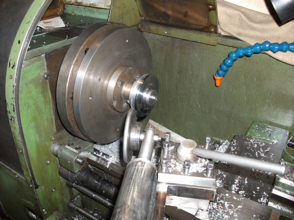

Hi Iain,
Try annealing the brass before spinning,carefully heat all over to nearly red and
allow to cool.I use a wheel type of tool ,the one in the photo is about 4 inch in diameter.For inside edges
or sharp forms a mounted ballrace can be used as seen on right hand side.

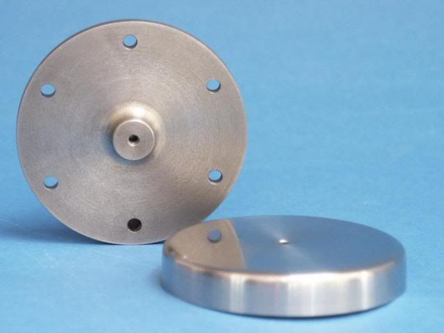

Hi Iain ,
Here is a better view of the spinning tool making something similar to
what you are doing ,material is stainless steel.

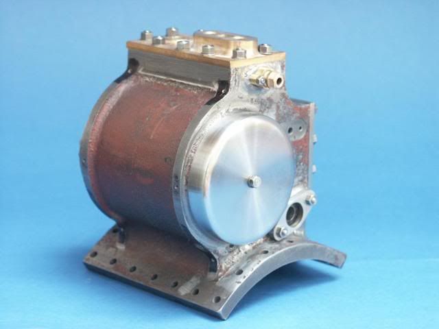

Well it does depend on who you bought it from at Ally Pally but I would say it's 95% likely you have a hard brass like CZ120 which will be difficult to spin even if annelaed, half hadd CZ108 would be a bit better as that is whats used when you need to bend it such as loco and traction engine tenders. Best for the job would be actual spinning brass CZ106 which is even softer.
3mm thick is also going to need a hell of a lot of force to spin, try something 0.5mm to 1.0mm thick.
I have spun steel using a rounded hardened tool held in the toolpost, this cap on the end of the cylinder was done that way and for a one off easier than making a load of spinning tools and rests.
