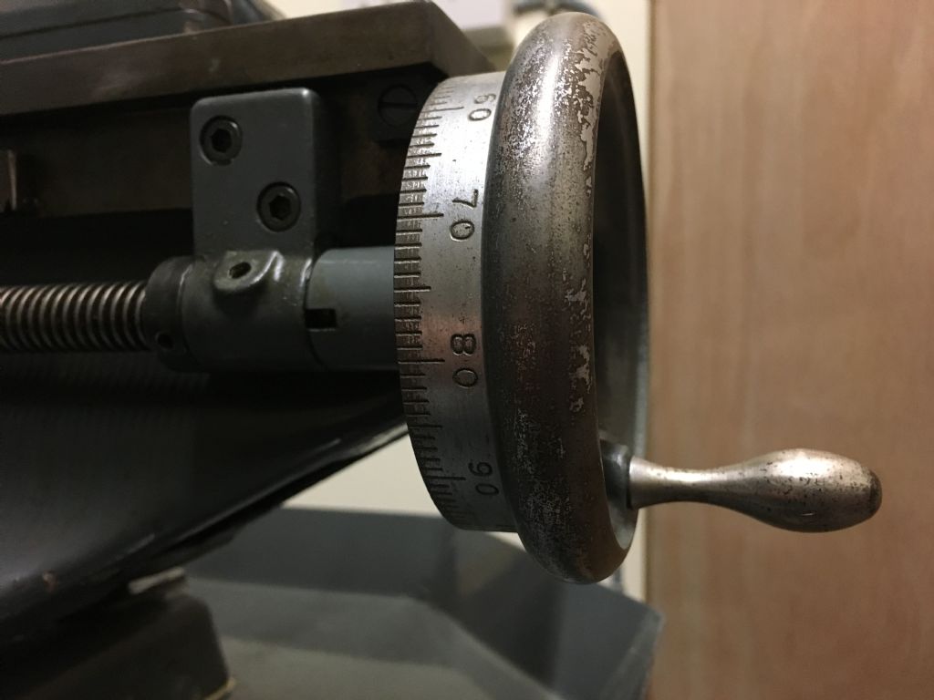

As the photos show, my leadscrew handle is very patchy and cross slide wheel patchy; I wish to restore them both to ex-works finish.
Were original Myford hand wheels "hard chrome plated"? If so I was interested in having a go at home chrome plating. But having read this reference, I realise that would be irresponsible! https://www.finishing.com/faqs/chrome.shtml
Does anyone have experience of sending bits off to be replated at specialist electroplaters (I am yet to get a quote)? Or is it cheaper to just buy new handwheels?
Any advice gratefully received.

When I refinished the handwheels of my original ML7, I stripped the paint and then gave them to a specialist plater who nickelled them and finally chrome, the so called Tri Chrome process, the best. Still good 60 years later!

"Tri" chrome process is copper, nickel then chrome. Be aware that copper will adhere to rusty surfaces whereas nickel will only adhere to sound clean surfaces.

Last time I looked into chrome plating for similarly sized motorbike parts I came to the conclusion it was cheaper to buy brand new replica parts. $120 to chrome a headlight shell vs $80to buy a new one etc.
On my ML7 I used a wire wheel on the bench grinder to remove the rust then rubbed the remaining rough spots with scrunched up aluminium foil dipped in Coca-Cola. Did a passable job.

If you really must have a chrome finish on your handwheels it will end up being cheaper to buy new ones .
There is a difference between hard chrome and brite or decorative chrome - hard chrome is chromium plated directly to the parent metal and is typically used on piston rods , bearing and seal journals because of its low friction and hard wearing qualities and can be built up many thousandths deep , it is not overly corrosion protective as chromium is porus so for harsh enviroments a thin nickel base plating is used .
Decorative chrome is plated over copper and or nickel base plating and the chrome is only a few tenths of a thou thick .
The labour cost alone these days to strip , clean up and re plate will be pretty steep and its not just a matter of chucking it in a tank and turning the power on , they have to be jigged up and anodes sorted or made to get the chrome to plate in everwhere then you have to find a shop that wants to do it as used cast iron or cast steel will have oil impregnated in it and this can cause all sorts of problems in the plating process ,
If it were my machine and i wanted to improve the look i would maybe fork out to get them stripped then polish the rim and knob with 600 grit emery or wet and dry then paint the spokes and hub , many old machines had this and a little light oil on the polished parts will slow the rust down .
I can't say i like chromed handles i fitted some to my mill and find they are to slippery but at least they are better than the plastic junk that it came with !

1. Chemically strip.
2. Polish.
3. Replate.
A high quality job needs all 3 processes above to be top notch.
No 3 will be crap to look at if No. 2 has'nt done a good job, regardless of the quality of the plating.
High quality triple chrome plating is never cheap because of the 3 processes above, the chemicals, the H&S, and the experience of the workers.
A lot of people still think "give it a quick dip and it'll come out like new" is what is involved. Could not be further from the truth...

The handles on my ML7 were all in pretty much the same shape, I just stripped them down and using various grades of emery, removed all the grot and pitting, then wet & dry papers until I'd got a good shine on them, gave them a wipe with an oily rag and they've been good as gold ever since.
Might not be quite as shiny as chrome, but quicker and cheaper than plating, depends really whether you want a showpiece machine or a decent looking workhorse, but if chrome is a must, then personally I'd buy new handwheels.

When faced with Myford handwheels that had peeling chrome plating, I just turned off the chrome plate down to the cast iron then went over it with a form tool to get a good round shape and polished in the lathe chuck with emery.
Then polished to a high gloss on a stitched cotton wheel with polishing soap and they were shinier than chrome. A wipe over with an oily rag keeps them that way
