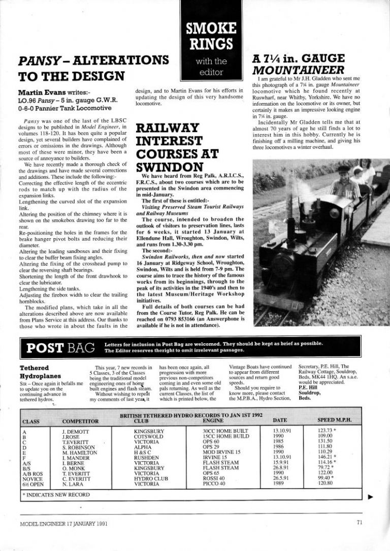

Richard - I set out to make one of these many years back. There are numerous mistakes on the drawings, one that springs to mind is the position of the brake hangar pivot holes. There are also errors on the valve gear but it's too long ago for me to remember where and what.
I was told that there was a list of errors published in Model Engineer and after contacting them John Crisp who owned Reeves at the time located a copy and sent them to me. Whether you would get the same response now I have no idea but John was very helpful indeed.
It was at least a page, possibly two as I recall and detailed the errors and dimensional mistakes. Unfortunately I can't tell you which issue of ME but I can say with certainty that it was published.
If you get your hands on the original articles you will find that the error on the brake hangars mentioned previously do not get dealt with until the last instalment!
Good luck with your engine but do check and double check before machining those important dimensions.
Regards - Ramon

I've managed to acquire some issues from volume 118. 2968, 2969, 2970, 2971, 2972, 2973, 2974 and 2975. They do have further issues from volumes 118 - 120. I will see what info they hold, and if helpful purchase the rest.

A huge number have been built, and run very well ,staying and working in steam for 8 hours or more, but a little advice , start building ! while it is well worth while spending time looking for errors, it is so easy to wait until you think you are going to build the perfect engine, it will never happen, Doug Hewson has redrawn , and produced lazer cut part to scale, Don Ashton has produced improved valve gear arrangements, I thought I would do the same for theB1 ( Springbok) which has more errors than would fill a book, and wasted years, could have had two built two by now LBSC did produce engines that would run and work, go fot it!!

The Martin Evans corrections are partly true but do not deal with lots of fundamental errors with the valve gear and much else besides. John Baguley and I arrived at different ways to deal with the valve gear which has considerable problems as drawn, and certain dimensions that are critical (but wrong) are only in the construction series.
