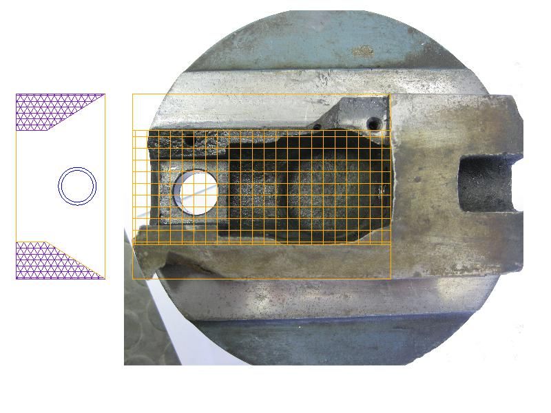

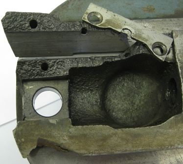

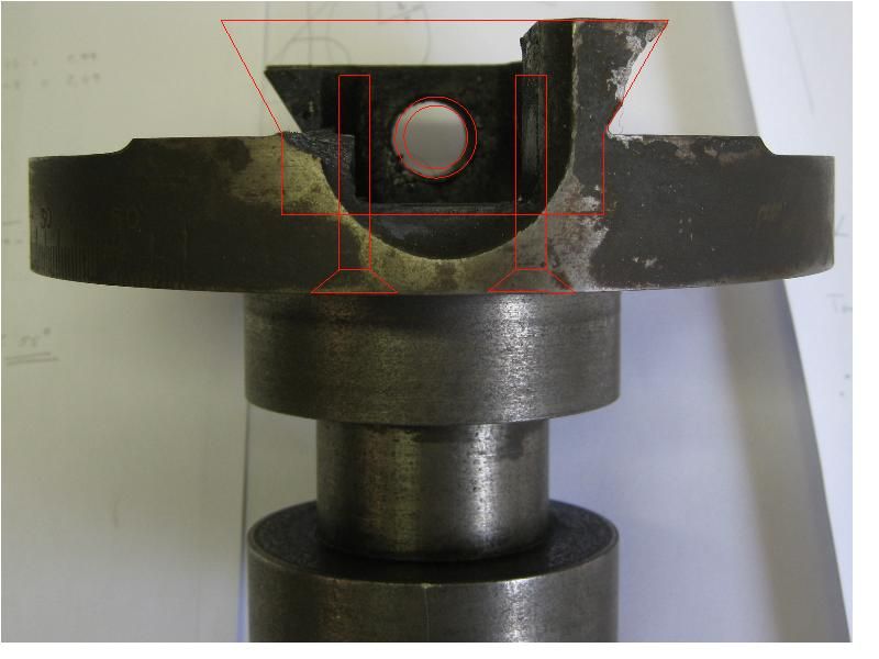

Joseph Noci 127/06/2017 11:17:31
1323 forum posts
1431 photos
I am pleased that there are other options rather than the cast iron - I am finding it almost impossible to obtain cast iron. 'Cloggs' even suggested Bronze, and I think that's a jolly good idea! I am going to try source a chunk and do it that way - if it does not work I can always try again with cast iron...(!).
I am going to try machine out entirely between the two dovetails, to a depth that is sensible and leaves enough meat on the head, behind the dovetails, and locktite and bolt/screw in a T Block of bronze, and then machine the dovetails to match the remaining part.
The Actual Break:
What I hope to do:
The whole thing is fraught with much pain...
From South Africa I can only get 45deg and 60deg dovetail cutters - these dovetails are 55deg..
Also, the dovetail is 17.5mm tall, so I need a big cutter. I see a manufactured cutter in my future..
Joe

Looking at your red outline you don't even need a dovetail cutter to make that part. Just angle the work or mill head

The bugbear will be that while it should work fine, if you have a crash it may split at the screw holes.

Joseph Noci 127/06/2017 20:19:27
1323 forum posts
1431 photos
Neil;
I see no other way of fixing the replacement dovetails in place, short of making a whole new head.
Jason;
I thought of tangling the part and using an end mill - problem is getting the new part to align properly with the remaining old part. Dovetailing in situ would allow correction of any linear misalignment of the new block.
John;
I am intrigued by the dovetail cutter you made. Can you explain a bit more for me please? How did you do the cone before slotting in the carbide rods? Was it just a , say, 45mm diameter 55deg cone , holes drilled at 55deg very close to the periphery, almost breaking out but not quite, and then machine the cone down to expose the holes, ie, remove half a hole, slot in the rods and silver solder and then grind the cutting edge open? I think you did differently, since in the first photo I see the soldered length of the rods are already almost fully exposed, not siting in 'half-holes'.
I have a quantity of 4mm square HSS , about 150mm long each. I could cut those and mill slots in the cones sides to fit, but would silver soldering the HSS not ruin the temper/hardness? Re-hardening/tempering in-situ would not be easy.
I like the idea and am interested to try something along these lines. I was looking at making a cone, milling flat faces to take the rhombus shaped carbide inserts, the smaller included angle is about 52 deg. I was thinking of silver soldering the inserts on to give more rigidity to the backing. The inserts are small, about 12mm long x 7mm wide, so I would have to work down the dovetail sides - could not cut the hole dovetail length. But your implementation is very attractive. Please tell me more!
Regards
Joe
