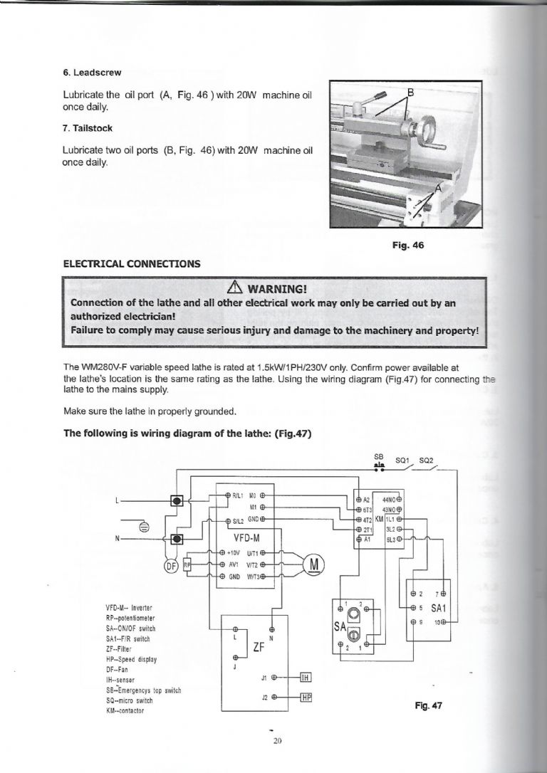

Right, so I have recently bought a WM280 lathe from Warco and after unboxing and cleaning it from the sticky wax I gave it a try to confirm it's working fine.
Power on with no issues but when selecting FWD nothing happens, if I put it to reverse it operates correctly, spindle turns and auto feed operates when engaged.
Is there anyone out there familiar with this lathe who could guide me to some trouble shooting, if I'm doing something wrong or what should I check before contacting Warco?

I agree this is probably one for Warco, but I think you could look at the wiring behind the headstock without voiding the warranty.
You know that the motor and VFD are OK because the lathe works in reverse. That suggests a minor electrical fault and points the finger of suspicion at the reversing switch SA1 and the wiring between between it and the controller.
The wiring of these lathes is untidy and it's possible that something has come adrift in transit. Check to see if any wires are loose and that the terminal screws are tight.

As the lathe uses a VFD the reversing is probably done by the VFD. The reversing switch probably just routes a low voltge control signal (Probably 12 or 24 volts) to one of two input terminals on the VFD. If you were supplied with the manual on the VFD then it should show which terminals select forward and reverse. If you don't have the manual then you may be able to find it online. I agree with the comment about contacting Warco before looking at the problem yourself.

I don't think the lathe is wired the way I was expecting. I think the switch connections showing 50 volts (I assume your reference point is ground.) are probably driving relays. I don't have a wiring diagram for your lathe so I would only be guessing how it is wired.

I have found that I have a schematic for the WM250 (VFD version) and I have made some notes in the past.I suspect that the WM280 will be very similar. This is the schematic.
These are the notes I made.
Notes on WM250 schematic
Contactor KM
A1 & A2 are the coil
43 & 44 (NO) are the maintainer contact
Suspect
2T1 & 1L1 Normally open contact
4T2 & 3L2 Normally open contact
6T3 & 5L3 Normally open contact
Start/stop switch SA
Start button will be the top two connections (1 & 2) (Normally open contacts)
Stop button will be bottom two connections (1 & 2) (Normally closed contacts)
Suspect that connection 2 is common and 5 and 7 are forward and reverse
Forward/reverse switch SA1
I suspect connections 9 & 10 will be closed in forward and reverse. (And open in the middle position ??)
END OF NOTES.
I think the common, forward and reverse contacts on the switch go to the VFD via three sets of contacts on the contactor.
Chris, WITH THE LATHE DISCONNECTED FROM THE POWER can you do the following continuity checks.
Forward/reverse switch Contactor VFD terminals
2 --------------------------------- 1L1
5 --------------------------------- 3L2
7 --------------------------------- 5L3
2T1 ------------ GND
4T2 ------------- M1
6T3 -------------- M2
The if you can manually close the contactor do the following continuity checks while holding the contactor closed.
1L1 to 2T1
3L2 to 4T2
5L3 to 6T3
You should get continuity in all these tests.

Hi Les, the schematic is identical to what I have on the WM280V-F manual so it should work out for me. I'll do those checks tomorrow morning and post an update. This afternoon I opened the switch covers an had a quick look inside before I left for work, wiring is not the tidiest I've seen but everything looks in place, nothing loose. Included some pics of what it looks like. I'll have a closer look tomorrow, maybe I missed something.

Apart from being untidy, the wiring diagram looks a lot different to most other VFD controlled machines. However the schematic itself is not very informative (its not clear what is inside the various boxes on the diagram) so working out how it functions without having the thing in front of me is not easy.
It appears that the interlock switches are at mains voltage which is not ideal.
The filter (ZF?) does not appear to filter anything.
Where is the speed control potentiometer? (not relevant to Chris's problem but shows poor documentation)
What is the contactor for? Most (all) VFDs have logic that eliminates the need for an electromechanical relay
Warco's electrician has some odd ways of working, if it was my lathe I would rewire it!

The contactor on Chris's lathe (like mine) is a Siemens 22E. That's left me confused because the spec says it has 2 normally closed and 2 normally open contacts, which I have yet to understand given the circuit diagram.
Anyway, ignoring that, Forward and Reverse are selected by grounding VFD terminals M0 / M1 respectively. M0 and M1 are at 5V. Grounding is done via the contactor, presumably so that the lathe stops as soon as any of the interlocks are broken.
An easy check is to flip up the hinged cover at the base of the VFD. (It's marked with the yellow warning triangle in the photo.) Lifting it reveals the control screw terminals which are labelled helpfully. M0 and M1 are on the left of the terminal block and the ground terminal is first right after M5. M0 sets forward mode. M1 is reverse. If you're lucky the M0 wire has fallen out.
With the lathe powered up and the motor on with forward selected, there should be 0V on M0. With reverse selected, there should be 5V on M0.
