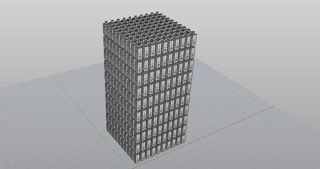

Bob n About29/03/2017 11:47:26
60 forum posts
1 photos
There above is a 10 x 10 x 10 array with 2mm spacing and a 2mm joiner in Z for SLA printing. The whole thing is 60mm x 60mm x 120mm tall. Two of these prints would give you your 2000 parts. In the long run this is probably the quickest and cheapest method.
Bob n About29/03/2017 11:51:45
60 forum posts
1 photos
P.S it you buy me an SLA printer I will do them for FREE cool
Holes should be treated as approximate size.
