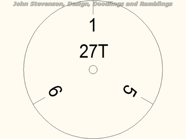

OK, bit more time now and first off a big thank you to Mark Frampton who replied early on last night by Pm with some very clear and valid argument that it should be 12 equal divisions but some like 2 6, 8 and 12 don't need to show.

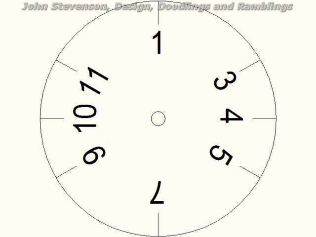

This was later confirmed today by the forum but in the meanwhile I had done the exercise in CAD. and got this.:-
I then went one step further as I used to have a Russian tool-room lathe that had the 3 metric gears but had a dial for each gear to cut down on clutter.
So this is the 27.

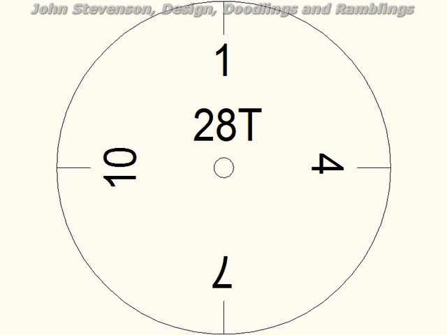

Now the 28.

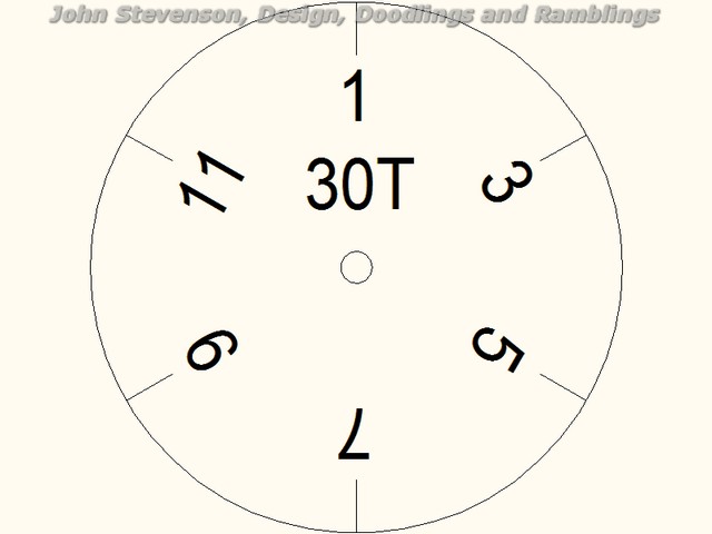

And lastly the 30.
All becomes rather obvious when it's laid out like that.
