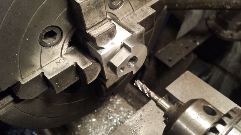

I've been reading a book that describes how to accurately position holes using buttons. Basically, I think it says:
  • drill and tap a small hole approximately in the right position using the usual methods.
  • screw the button to the hole
  • accurately position the button. (The hole through the button is bigger than the screw so the button can be moved relative to the screw. )
  • Mount the work on a lathe faceplate or 4 jaw chuck
  • Use a DTI to accurately centre the position of the hole using the button
  • Remove the button and bore out the hole to size
It's very possible I 've misunderstood the book, but the method seems to rely on correcting a mildly inaccurate pilot hole by boring it out. My smallest boring bar starts at 9mm diameter. Does that mean that the method isn't suitable for accurately positioning small holes, or am I missing sometjhing?

You could always make the first trueing cut with a 2 or 3 flute milling cutter held in the tailstock which should be less likely to fiollow the wayward pilot hole than a drill.
That's the way to do it, keep the center fixing screw as small as is practical

Don't let the 9mm bar limit you. You can buy or make much smaller bars. You can grind one out of a square tool bit or an old end mill.
The standard screw for toolmakers buttons made by Starrett or Brown and Sharpe was 5-40 (1/8" dia.) I suppose a smaller screw could be substituted.
the smallest bored hole when using buttons would be one that just removed the pilot hole.
+1 on using an end mill to true the hole before boring to size. It is short and rigid. Its square end will not follow the pilot hole.

If you locate the original threaded hole somewhere near where you want the centre of the finished hole to be, you can just drill it out with a drill that is somewhat under the finished size of the hole. Does not matter if it is slightly off centre, as long as the hole is big enough to fit your boring bar into but small enough that it does not break out of the desired location of the finished hole.
So, for instance, you might use a 3/16 tapped hole to locate the toolmaker's button to correctly locate a 1/2" hole. So once the job is set in position, you drill the tapped hole out with a 3/8 drill, even if it wobbles about say 1/32" off centre. Then when you stick your boring bar in there and clean up the hole to 1/2", the boring bar will cut true to the centre of rotation rather than follow the wobbly hole.

For small holes you do not need to fully bore the tapped hole to correct it. It can be done with a graver or better still (if somewhat cack-handed & short sighted like me) a slim 'pointy' tool held at centre height in the tool holder. The aim is to come in at a 30 degree angle and effectively chamfer the edge of the previously drilled/tapped hole - which if correctly marked out in the first place should not be too much out anyway. This will true the hole and help guide the following drill in about as accurately as you can do so. I'd use a new drill for the job if possible.
I've done this on a set of gearbox plates where I wanted the mesh to be as good as I could get it and I didn't have a small enough boring tool for the holes required (and frankly was too idle/impatient to make one). It's exactly like using a slocome (centre) drill to start the hole but where you know the 'cone' will be dead on if done carefully. My old S7 tailstock has quite a bit of droop in it - so it's not ideal for really accurate drilling and sometimes needs my help. Obviously, fully boring the hole out is the better option but this is a workable alternative.
