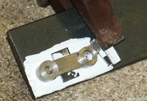

As Mechman says tippex correction fluid will keep the solder off, must be the solvent based one.
Here are some bits pegged to a steel plate to keep them in place while soldering, you can see the tippexed areas
All came off the jig OK

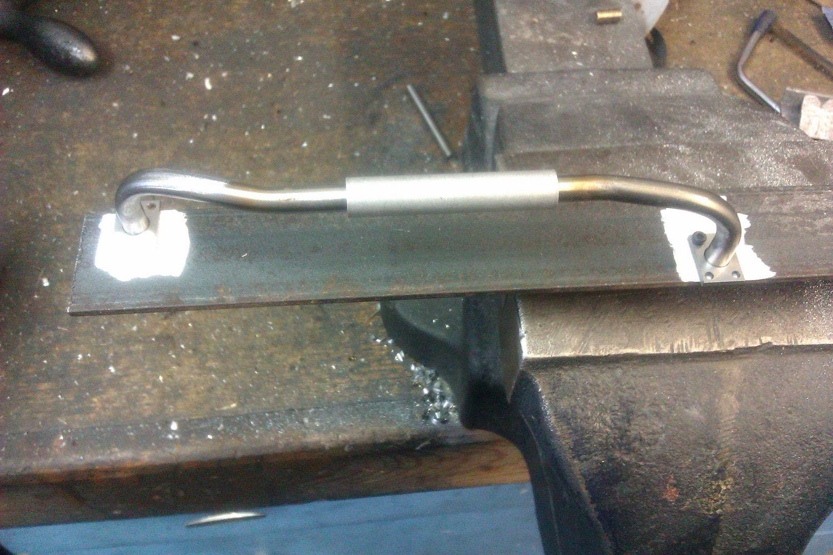

Same again stainless steel parts screwed to a steel jig

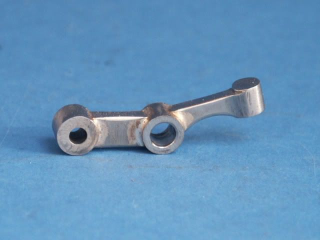

And finished part
