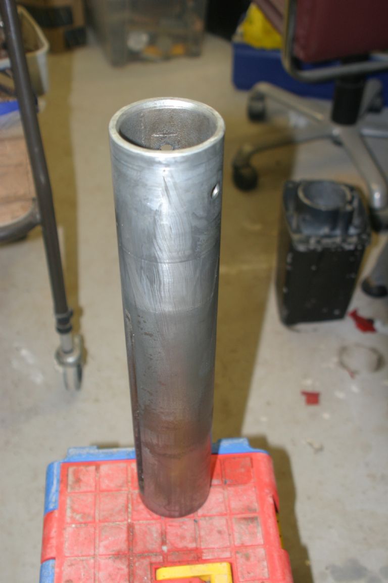

Cornish Jack19/10/2016 23:21:23
1228 forum posts
172 photos
Roger
I have a piece of steel tube which is there or thereabouts for your requirements. How specific are the dimensions? I've only just done a quick dash to the shed and put a plastic vernier on it but if you are interested, I can do a more accurate check tomorrow. The tube is a 'pull' from a Shopmate radial arm saw and (to my eyes) is a rather nice piece of material. PM me if you need more info.
rgds
Bill
Cornish Jack20/10/2016 11:06:05
1228 forum posts
172 photos
Roger
As mentioned above, I have now more accurately measured the tube referred to and photos below.img_9110.jpg
Photos to show the modifications to the tube - keyway and attachment holes.
The measurements are Imperial 'cos I can't find my metric vernier!blush
Tube diameter - 3.01"
Wall Thickness - 0.305"
Overall length - 17"
Distance top to start of keyway - 6"
Keyway length - 9"
Keyway depth - 0.3"
The keyway does pose a problem but someone with John Stevenson's ability to convert 'Sow's Ears into Silk Purses' could undoubtedly make the full length useable.
If this is of any use please let me know.
rgds
Bill
