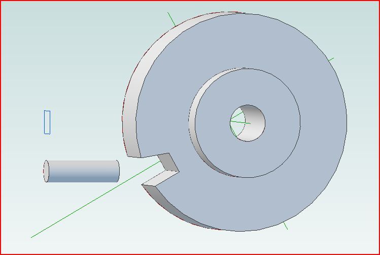

i want to make several capstans for my ml6 lathe so i can just swap complete units over and leave them set up for certain jobs.
need to make the bit in pic someone at club suggested broaching it.
never seen it done so wondered if one of the wsp series of books cover it?
and where i could get one made as can only see normal keyway ones.
or is there a better way?
i don't have a milling machine.
thanks

mick7010/10/2016 14:11:36
524 forum posts
38 photos
its 60mm across and 15mm thick if that helps?
overall thickness is 22mm.
its just the base piece.
give me 5 mins and will try to strip it and get better pic.

mick7010/10/2016 14:19:30
524 forum posts
38 photos

It looks, to me, to be a turning and milling job. Perhaps not simple for many of us, but more of a setting up problem for the angled cuts, but apart from that no real basic difference than cutting a gear?
The no milling machine is the problem to get over.  Local college course?  Friendly local group?.
Looks heavy for most vertical slides on a lathe, but doable if really wanted.

A bit of lateral; thinking - what shape is the ratchet that fits into the cut-outs? Is it possible to drill or mill a simpler shape that will index just as well?
With a hefty vertical bandsaw you could remove most of the waste with four cuts leaving a relatively simple milling job.
Or get an apprentice to do it with a hacksaw and a blunt file

Make a simple cutter much as you would if making a gear cutter. Run that on a mandrel and use the vertical slide to move the work up into the cutter.
Just think of it as cutting a Vee form gear tooth, plenty of info on gear cutting setups for the lathe

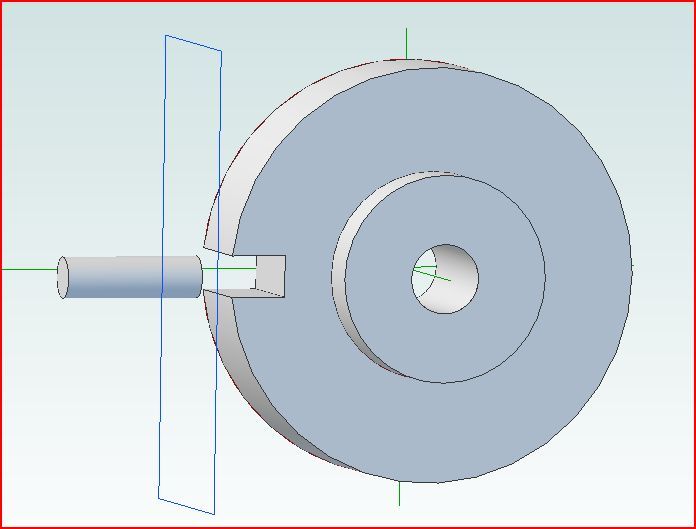

Another simple way to do them on the lathe.
Put an angle plate on teh cross slide with a stud on it and sort a simple way to index 6 times. Mount blank on stud and then use a milling cutter in the lathe spindle to cut a slot the width of the Vees base, do all six in each plate.
Move the stud up so that you can then use the same cutter on ctr line to cut one of the sloping faces on all Vees
Either move stud down so you can do all the opposite faces or leave the stud where it is but put the other face of the blank against the angle plate.
Quite a simple method that does not need the work outsourcing or require making a spark eroder.
EDIT
Quick sketch of how it could be setup, angle plate on cross slide, bit of bar fixed to that with a stud surrounded by 6 peg holes. Put teh blank on the stud and use a peg through the dowel hole that is shown in your photos. Just raise/lower lower the flat bar and angle it as required to get the cut to side cuts to teh vee

Originally these would have been done on a horizontal mill with a shaped Vee cutter and indexed round in a dividing head. The the most cost effective way to approach a production job like this as they wouldn't just make 1 or 2
Jason has got the best idea so far, simple, cheap and doable on the equipment that the OP has. Most, as usual failed to read the no milling machine bit.
If it was me ?
I'd do roughly the same as Jason has proposed but lay it down and use the tool post bolt as a pivit with nessesary bush and use a slitting saw between centres on a mandrel.
These slots believe it or not are not that critical on every feature. The critical bit is the angle and width of the slot as they are located by a tapered wedge. They don't need to be flat bottomed as noting touches the bottom so you could drill 6 holes for clearance and allow the saw to run into the hole.
Print the shape up in CAD on a bit of paper and stick it on the blank then offset to one side so the cut is radial to the centre and cut 6 slots, then move the blank to one side to line up the other side and cut those 6 slots.
Indexing believe it or not isn't critical either as you bore the turret for the detent positions.
