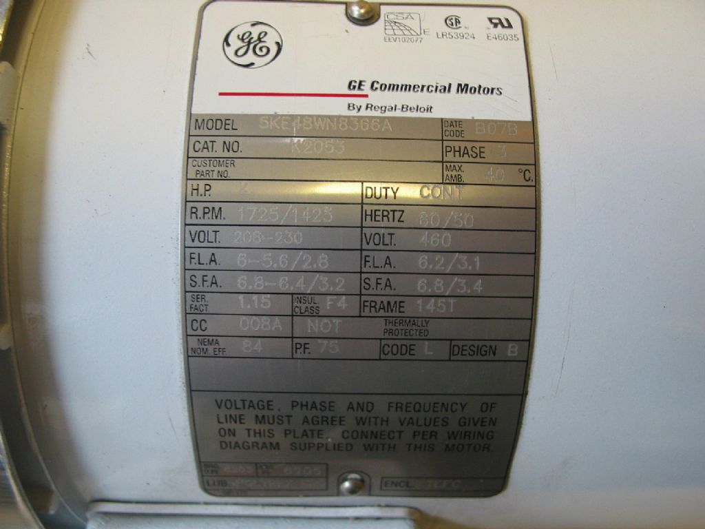

s-l1600.jpgHi , Im always unsure when i look for suitable motors and especially the electrical aspects of machine tools.But is the motor in the photo suitable to run a milling machine through an inverter??
I notice it says there is no thermal overload protection is that a big problem?
Its a washdown motor but i like the idea of the extra protection from the environment you get with these motors as my workshop isnt exactly ideal and often gets damp .
Thanks

It's dual voltage, and from a good manufacturer
... So my answers would be:
Q1 = YES
Q2 = NO

All the NOT protected means is that there is neither a thermo-switch, nor a thermistor embedded in the windings to wire back to the control terminals of the VFD. Modern VFDs provided a lot of protection anyway if the motor rating information is set correctly (some can even measure/calculate this for themselves). If planning extended running at low speed, or lots of stop/start cycles in a short time, extra thermal protection might be more important.
I wouldn't be worried about a little damp (as long as your cable glanding is sound) - standard TEFC induction motors are often installed outdoors with no weather protection.

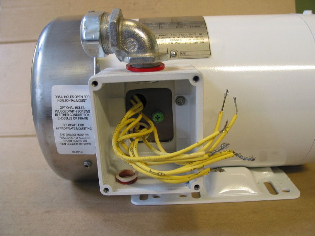

s-l1600b.jpgs-l1600a.jpgThanks Michael good to know. Another question, these motors don`t appear to come with a terminal block ,what would be a suitable type for this?? They have 9 numbered wires coming out .
See photos.

Posted by mark smith 20 on 26/07/2016 11:12:06:
That's quite unusual ... But nothing to worry about.
I would probably use one of the better quality 'chocolate block' strips [the ones with protective leaf springs inside] to avoid damaging the wires.

I would have thought that although it is rated with dual voltages, it could still be used with an inverter.
It is common for three phase motors to be capable of being wired either star or delta. The impedance of the winding is different in either configuration. The rating plate should say if the rating is star or delta. If it does not, you would probably assume that the rating is for delta. This is how larger/older motor rating plates work, to allow for star/delta starters.
In your case the label inside the connection cover implies that the two voltages on the rating plate are for delta and star respectively. I'd say that you can use that motor with either a three phase or a single phase input inverter.
It does depend very much on what inverter you obtain to use with it. Generally an inverter with a single phase input will only have a fairly small output voltage rating. A three phase to three phase inverter would normally have a much higher output voltage rating. This is not a rule, just an observation.
To compensate and get broadly equivalent ratings from a motor at different voltages you would wire 240V delta and say 415 star. If you just want the maximum from the motor, wire delta whatever the supply. If you want efficiency and/or low inrush wire star.

It's a standard American 9 wire motor. We use 6 wires, 3 for star and 3 for delta like 95% of the world,

I'd use a rigid type terminal strip rather than the soft nylon type, they are more like the material usually found as terminal blocks in motors and may be more resilient with regard to fretting due to vibration.

Normal method of connecting these is to crimp ring terminals to both motor & supply wires and nut & bolt them together, using both flat & spring washers. Then insulate with PVC boots held on with cable ties, or wrap with self amalgamating tape followed by PVC tape. An alternative is to twist motor & supply wires together & then apply an insulated closed-end splice crimp over the twisted ends.
I see this method of termination frequently on Korean, Taiwanese & Japanese CNC machine tools. I first came across the method while production wiring large lathes at Broadbent Machine Tools - but only on machines destined for the US. IIRC I was told at the time that it was a requirement of the American Electrical Standards that this method of termination was to be used, rather than the stud type terminal blocks European manufacturers normally fit.
