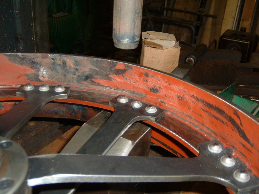

I have uploaded some photos showing how I am riveting the spokes to the rims for the 4" scale Burrell traction engines I am making.
The photos show the hydraulic cylinder used and the resultant rivet heads. using this tool I can use the as-supplied rivet head on the outside and from a head on the inside, where it is less visible.
Hope this is of interest.

hi Paul,
the rivets are 3/16" steel round head and 3/4" long. The spokes and rim are 6mm, leaving 0.277" for the head. More or less equal to the 1.429D setting allowance specified for a formed round head.

hi Andrew,
I have a pressure gauge fitted to the hydraulic setup and I take the pressure to about 3000psi for 3/16" rivets. For the cylinder I have made these pressure equate to about 5.3 tons. This gives the formed head as shown in the photos - unless it goes wrong, that is.

Geoff Rogers20/06/2016 11:59:46
30 forum posts
4 photos
I form the rivets in two stages; one to set and a second to form. I have found that the 'set' operation is most beneficial for two reasons, firstly to make sure the rivet fills the hole and secondly to stop, or at least reduce the chance of the rivet cocking over during squashing resulting in a very bad head. Rivet and I.

KWIL,
the cylinder is single acting short stroke and made from SG cast iron. The piston is two part and fitted with a heavy section O ring. The piston/bore sizing is such that an anti-extrusion ring is not needed. The O ring is about 55mm OD and about 5.4mm section.
I have used the cylinder to close up to 1/4" steel rivets (the largest I need to close) and it has seen a lot of use so far with the rear wheel strakes and front wheel construction (I am making three engines). To date, no leakage and nothing broken. The dollies are made from mild steel case hardened at the business end .
