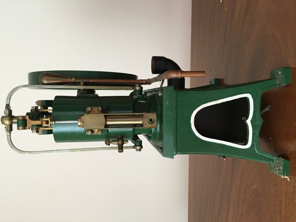

Would I be able to sell this working model that my Father made? If so what should I ask for it?

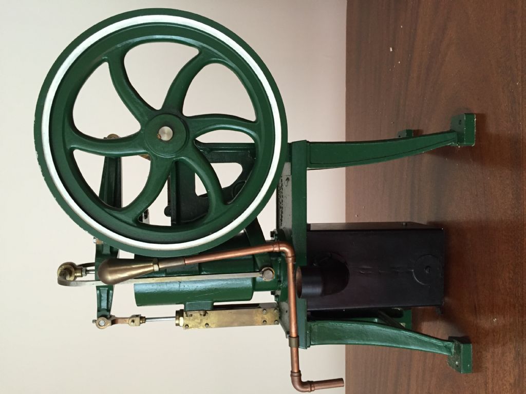

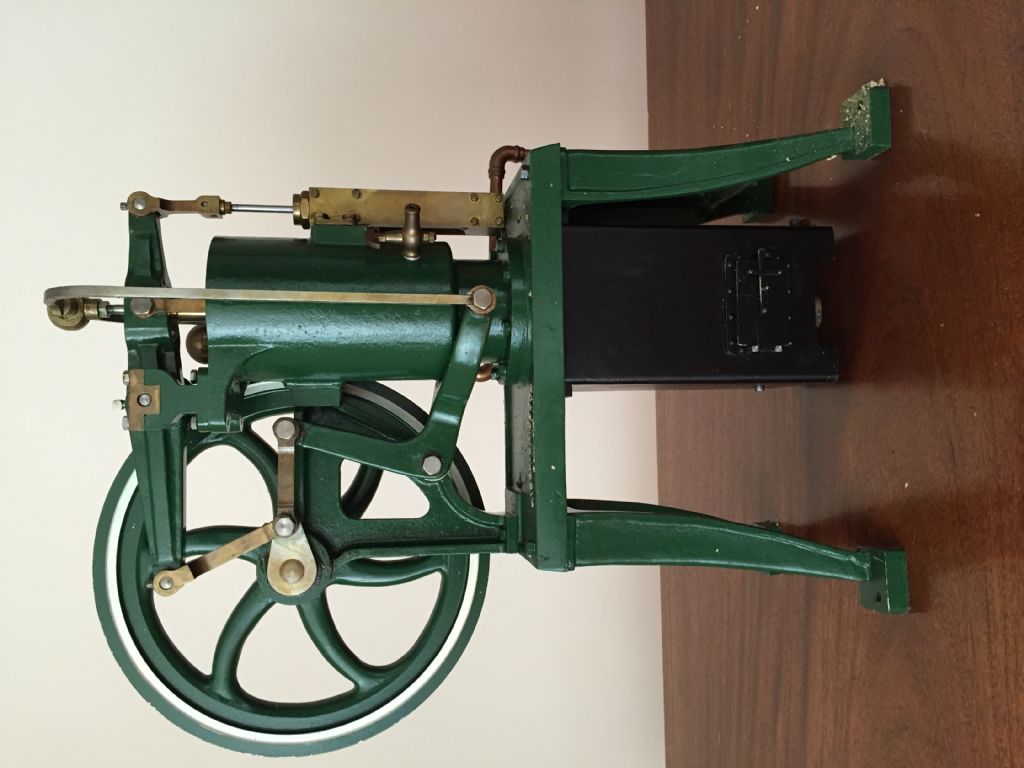

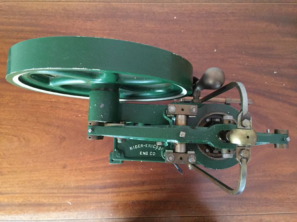

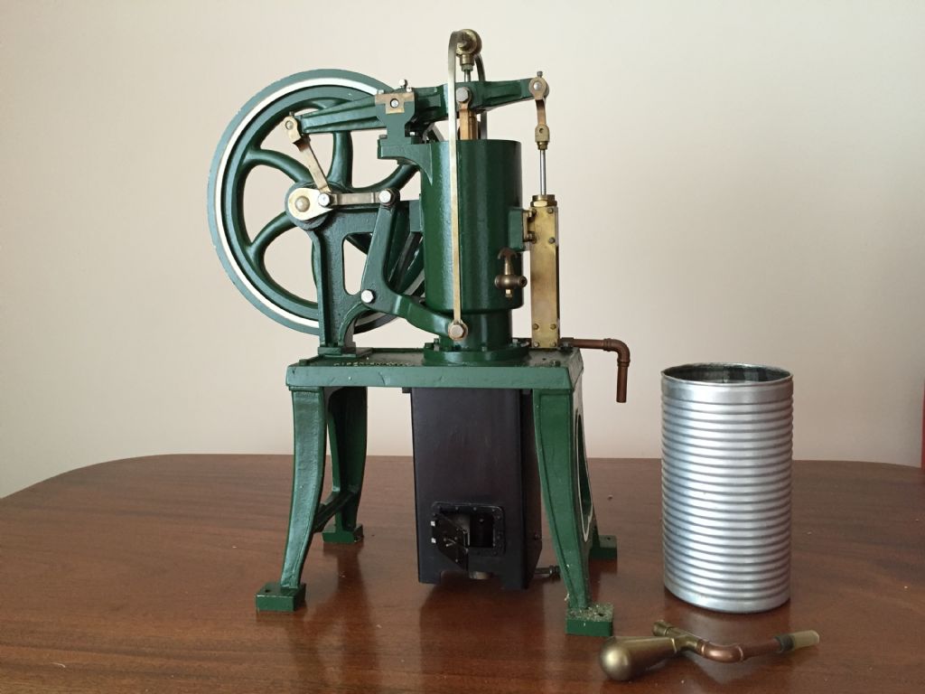

Thank you for responding Ian. With a little help have added photos, sorry not correct aspect!
The basic dimensions of this modle are: 17" high, 10.5" wide, wheel 9" diameter. Is this a quarter scale?
Amanda.
JasonB20/06/2016 15:58:09
avatar
25215 forum posts
3105 photos
1 articles
Its always a bit hard to put a price on an engine as most of us like to build the engine but there are collectors about too. The Camden one is a good size and this one looks to be well made, you could be looking at £1500 plus
Yes 3" to the foot is 1/4 scale

Thanks Amanda, that's a beaut looking motor, Jason could well be right with his figures. Ian S C

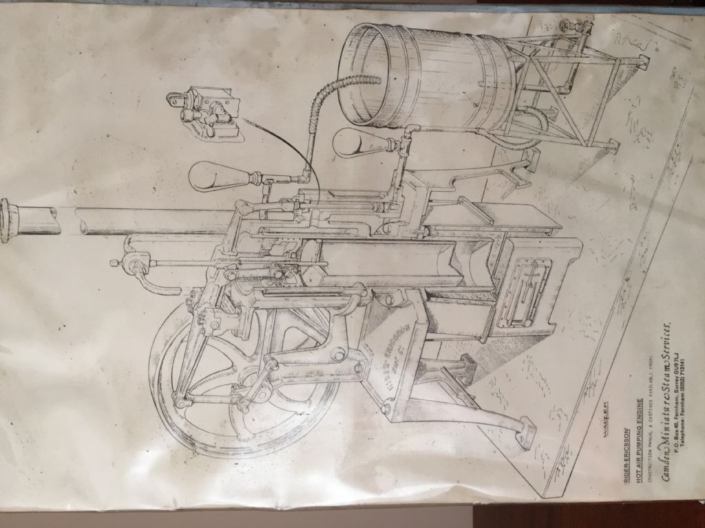

That model is one of the 'Rider Erikson' type of Stirling engine. Came as a real shock to me that the 'Erikson' was the same Erikson who designed the 'Monitor' used in the US Civil war and had a loco in the Rainhill loco trials. Quite a stunningly versatile engineer.
Regards,
Richard.
