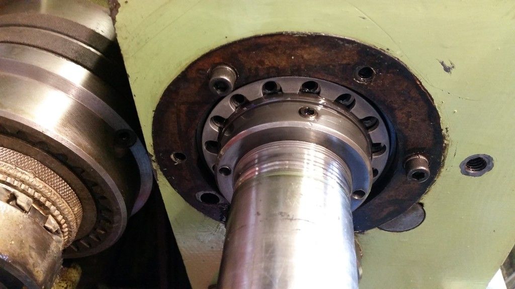

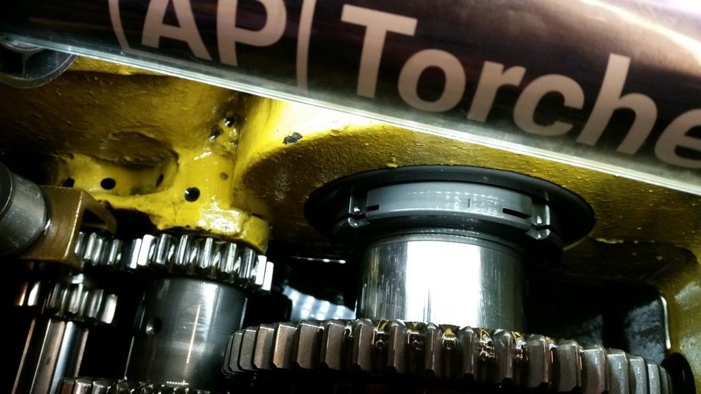

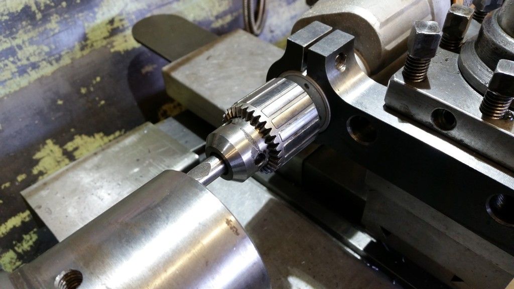

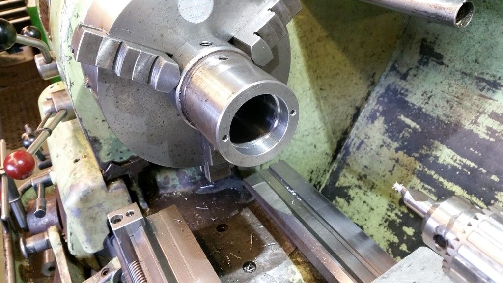

Bernard Wright16/05/2016 22:20:53
avatar
90 forum posts
16 photos
Thanks for the link John, I found I'd already downloaded that one along with several others, sadly none of them give any details I really require.
I took the lathe down a stage today and did some pics, but haven't altered anything yet, even did a bit of turning to make a pin spanner to engage the rear locknut...
This is the front bearing locknut... 2nd is the rear locknut...3rd is the pin spanner drilled for 3/16" pins to tighten the rear locknut...
Method of drilling in my lathe...
Bernard

I am horrified that anyone would suggest "a sharp tap" on anything near a Gamet bearing, unless you are intent on changing it!
Looking at the IPB in the Manual, it would appear that the "nut" on the front bearing can only be holding the centre bearing element to the spindle nose and does not play any part in the overall preload. Normal use of taper roller bearings is that the total preload is applied solely by the "nut" on the spindle rear pulling both bearing centres together, and hence preloading the whole.
There will undoubtedly be a firm, nay tight fit between the bearing inners and the spindle and that a puller of some sort may well be necessary to lighten the preload should you be so unfortunate as to set it too high.
Owing to a leaking front oil seal on my Harrison M300 I had to displace the spindle and to make a hydraulic puller frame to achieve any movement.
