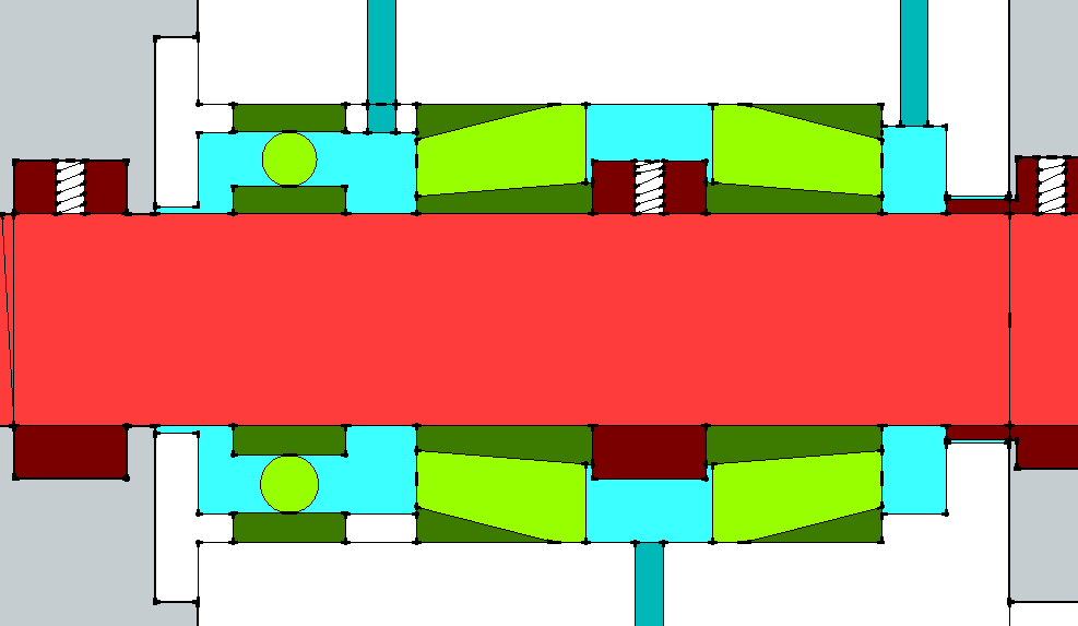

It turns at there is a limit to what you can produce on a plain turning 1.75" centre height lathe. Due to these limitations I'm prepping for a project of making a new 150mm centre height lathe.
Was looking on advice for the headstock.
Red is 30mm bar, dark red is shaft collars, green is bearings, yellow is pulley, white is solid housing cross section and blues are hollow parts of the housing.
In the front (left) bearing housing there is a deep groove ball bearing and twinned taper roller bearings.
The two dark blue lines on the top are oil holes and the one below is the oil drain. According to Timken taper roller bearings naturally pump oil through themselves as they rotate so the oil should naturally splash about inside and be directed into the centre to drain off.
My question is: Is it possible and/or necesarry to seal off the points where the spindle leaves the bearing housing? I don't want oil splashing out and I don't want dirt floating in. I was thinking of getting a shaft collar, turning a small part down to 1 mm under the size of the housing opening and screwing it in place which would stop large swarf getting in but that still aloows some oil and grit to move about.

Hi Rainbows
Some variations on your theme here.....
**LINK**
You really do need to keep the swarf out there are dozens of inexpensive mechanical seals available.
It appears your main shaft is not stepped? Usually there is a step that provides positive location and provides an opposing face to preload the tapered roller bearings.

Rainbows,
I agree with John M. You need seals. You also need a shoulder against the bearing race. You also need a shoulder for the chuck to butt against.
I would like to suggest some changes to make the headstock more robust.
Eliminate the ball bearing on the left side of the headstock. It adds little support compared to the tapered roller bearings.
Replace the two roller bearings with a single bearing of double row design. Place it as close to the left end of the headstock as possible, leaving room for a seal. That will place the bearings as close as possible to the chuck for maximum rigidity. Use shims under the bearing retainer to adjust preload. Timken and SKF have several sizes of roller bearings to fit a given shaft. That will give a choice of load capacity.
The ball bearing at the right can be a pre-lubricated bearing with seals.
Refer to the bearing manufacturers' literature for the proper fits on the shaft and housing.
I hope this is helpful.
John R

Your best option would be a "Labyrinth " seal, various types designed for lathe / milling spindles. Some designs involve fairly complex machining, other styles less so.

Re haveing no steps on the shaft: The plan was to have the shaft collars act as the chuck abutment face and to bear on the taper roller bearings. Doing this instead of turning the steps from a larger piece of stock is that at the moment I have no lathe that is big and accurate (I have one thats small and access to one with tapers and runout all over the place). Would using shaft collars be suitable for this?
One thing I didn't explain properly in the original.
The plate on the left is bolted into the housing. The design will probably need changing to accomodate a seal but the idea is the tighter the bolts are the more it is pulled in, pushing the ball bearing further in then though a small ring between the ball bearing and taper bearing preload the taper roller bearings and keeping everything positioned.
Will have a look through more of those alternate designs and look around for seals later today.

I'd get the taper bearings further apart, being so close together and in the middle of teh shaft you will not get the benifit of the taper and will still have the slight ply from the end bearing where you need the support.
Out of interest all my lathe has is a close fitting 3mm thick disc between bearing and the outside world, seems to work OK.

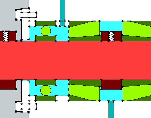

This is where I got the idea for that ball bearing. I assume SKF had their reasons so I blindly followed it even though I wasn't sure what the extra cylindrical roller bearing was doing there. That timken article is a great link though.
Am I correct to say that if I bought this then it would be a matter of locating it in the 62mm bore and it would keep debri out and oil in?

Hi Rainbows, The way I see it is since you are designing the lathe from the ground up then you have the opportunity to adopt "best practice" and utilise a proper seal for the bearings / spindle. I take me hat off to you for taking this on as it is no small task. It will involve considerable work ,and possibly expense [that depends on final spindle size ,Bearings ect] so best do it right. from the start. Labyrinth seals are designed for just that application A good place with all the info you could need re bearings for machine tools is
www.shaeffler.com there you can view or download a pdf . Remember also the bigger the spindle Ø the bigger the bore you can have, the down side is bigger bearings and more cost. It will certainly be a "challenge " so best get things right. Good luck.yes

Also as a aside, It need not be the super complex type of Labyrinth seal, there are a multitude of types from complex to less so. Many bearing manufactures make them, as do others that only specialise seals.

Those roller bearings "NN" have a very shallow taper to the inner race bore - they fit to a mating taper on the spindle and, when sufficient force is applied by the locknut, the inner race expands to take out the radial play. The oil port that comes out at the front of the spindle nose leads to a groove - high pressure hydraulic oil (think 10,000 psi + ) is injected here to help get the inner race off at rebuild time . This arrangement is favored by several German builders of heavy duty lathes - sometimes the pre-loaded double angular contact thrust bearing is replaced with standard ball thrust bearings. Very, very expensive in precision grades & can be very hard to find.
Note the labyrinth seal at the spindle nose, with drain hole at the bottom to let coolant out.
As a solution, this is way overkill for a small lathe IMO - opposing taper roller bearings at each end of the spindle as used by Boxford (for example) would be fine. If you cannot turn a spindle with a suitable integral location flange, could you design your headstock around one of the mini-lathe spindles, which appear to be quite cheap as spare parts ?

Why would it be a chore to make suitable labyrinth seals ? Not a difficult turning job & most do double duty as bearing retainers as well. Big plus with labyrinths over rubber seals is the lack of both drag & wear - a grease lubed rubber shaft seal will get hot & increase drag until it wears (and/or cuts a groove in the spindle), at which point it is no more than a labyrinth seal anyway. And some sort of seal is desirable to prevent coolant & swarf contamination of the bearing lubricant - grease or oil.
