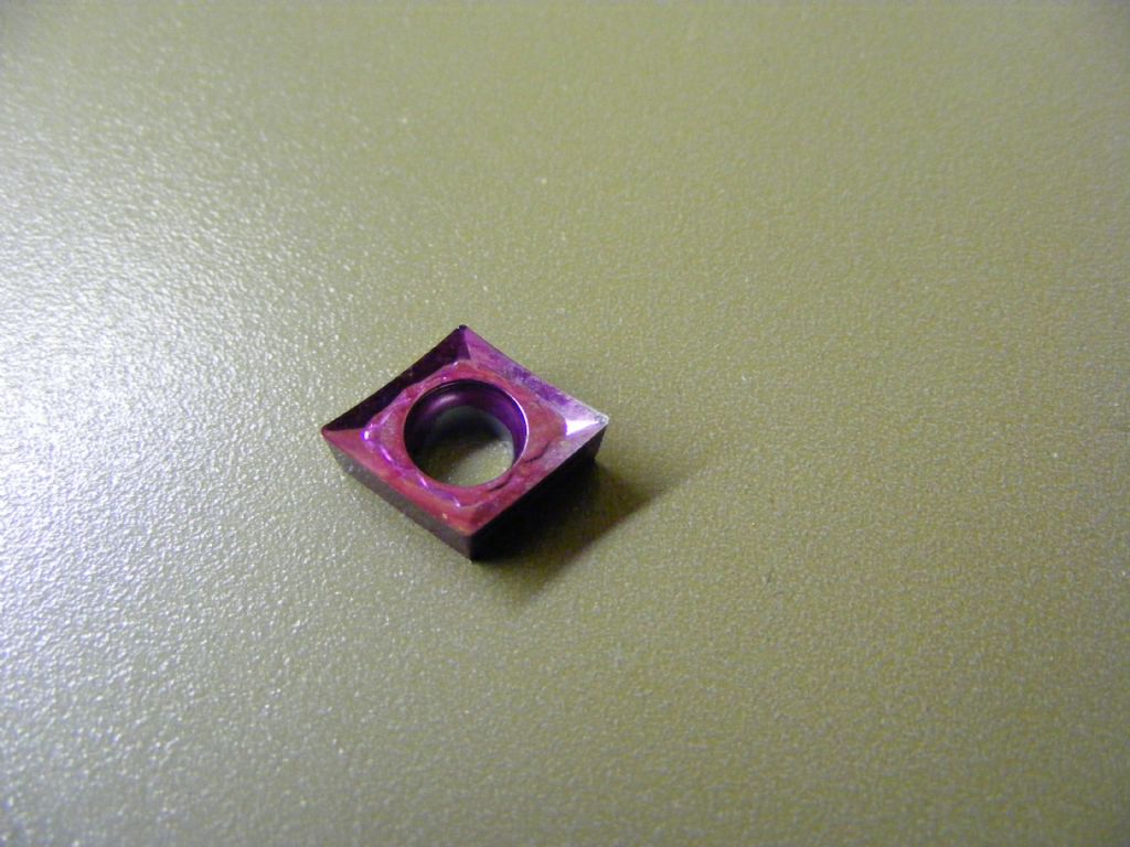

Raymond Anderson09/04/2016 11:39:50
avatar
785 forum posts
152 photos
Ajohnw, Hi John, Here is a CCGT tip that has seen a lot of use [only the first of the 2 proper corners ] It has been used mostly on En 1 and 8 and very little Aluminium. As you might be able to see it has lost it coating at the used corner [and did so a bit past] but the tip is still very sharp and still gives an excellent surface finish [please note, I always use flood coolant for steel] So I can't agree on your statement that once a coating wears off the finish goes down. Certainly not all tips are created equal, and that may have a bearing. This particular insert is Arno CCGT 090304 TiCN/ TiALN coated.
Cheers.
