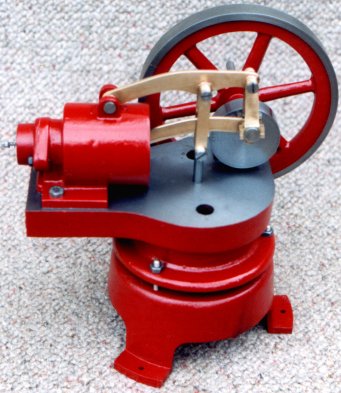

i managed to find this excellent section of a Robinson Engine, a B4 of 1914 on the Science Museum website.
It shows two rarely modelled features:
the regenerator (which makes it a proper Stirling Engine) the displacer is stuffed with wire wool.
A valve on the end of the power cylinder. I would have guessed this is to let air replenish the the system,. but it appears more complex than that with a plate blocking the transfer tub. is this sprung or does the nub on the piston open it except when the piston is at TDC.
I need Michael G. to track down the patent for me!

The end in question might be a pressure relief valve to prevent it getting higher than atmospheric or some figure close to it.

How about that valve being used as a speed/stop control?

Posted by Neil Wyatt on 01/03/2016 21:32:35:
Depends on who's model you look at all the Alyn Robinsons had the valve and regenerator

Before I check out your links, I explored my heat engines book in bed last night. The valve is a throttle - a form of governor. It also lists the patent numbers and dates... sorry for making you all work so hard blush
The patent is interesting, the section doesn't show a water passage. The throttle valve is governor operated, something I have never seen made. It does, however, detail a gas jet and even a chimney arrangement.
That section of a later engine is excellent, the only detail difference being a water passage between the transfer passage and the displacer rod - but is that box a water reservoir or a guard for the flywheel? The latter seems unlikely.
Most striking is that the displacer/regenerator is a close fit in the upper part of the displacer.
Also nice to see an 1880 example in action.
Much food for thought, thanks all.

Thought I had it tucked away somewhere, this is the section through the Alyn Robinson engine which is a close representation of the full size, you can see the valve, wire wool fille dregenerator and all the properly cored passages unlike some models that you have to drill achieve the same effect. Graham had/has access to a lot of full size engine so his models are true to teh originals.

Thanks for the extra info, especially the dimensioned drawing.

Very useful information, I've been searching for a year and drawing my layout,I was just about to start but will now have yet another think. As far as I can find out the smallest real engine was 7 1/2" bore, I'm making mine 1/3 scale, so 2 1/2" bore. I found a brass beer pump with this bore, so that fixed it. All the photo's Ive found are different, some have the throttle valve and some don't. Some have the water tower, I'm assuming that is what it is. Jason- do you have that dimensioned drawing with the cut -off dims' ?
