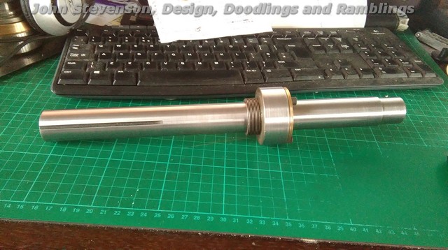

I've just bought a tailstock lever feed attachement for my ML7R from the ads here, ( thanks Nick)
It did not include the barrel or the threaded cap which screws into the right hand side of the tailstock. I plan to make these parts (after all I have a lathesmiley )
Question is:-
(1) does any one know what the internal thread in the right hand side of the tailstock is?
(2) Can any one with this attachement measure these two parts?
I've incuded a photo (taken from lathes.co.uk) which clearly shows the two parts I hope to make.
ie. the barrel and threaded cap.
Thanks in advance.

John Stevenson16/01/2016 21:13:05
avatar
5068 forum posts
3 photos
Think I might have a spare barrel and nut kicking about, check tomorrow as it's twenty past dark now and the workshop is haunted.

John Stevenson17/01/2016 12:46:42
avatar
5068 forum posts
3 photos
Is this what you want Ian ?
ian j17/01/2016 13:36:43
avatar
337 forum posts
371 photos
John.
That's brilliant , the very thing.
I've sent you PM
Ian

David Haythornthwaite10/01/2023 11:52:37
avatar
45 forum posts
7 photos
Hi Ian J
Back in 2016 You corresponded with John Stephenson regarding a long tailstock barrel for your Myford Super 7 and it appears that you bought the long barrel, complete with nut.
I am thinking of converting my Super 7 tailstock to lever feed, making the entire mechanism from scratch. I shall probably start by making a long barrel for my lathe, but I am concerned about drilling / boring such a long hole down it. If convenient, could you please measure your barrel and tell me how long it is so that I can plan how to make this part. I see that the cap has a brass/bronze plate on it and presumably this forms a bush for the tailstock barrel to slide through.I have the normal barrel on my machine and should have no problem in creating a new cap with a bronze bush in it.
I hope that you will be able to advise me.
David H
noel shelley10/01/2023 13:12:45
2308 forum posts
33 photos
I to have this attachment with the barrel and cap/nut missing, so add my name to those who need help please. Hopper may have drawings or I can help with dimensions all the other parts.  Noel.
