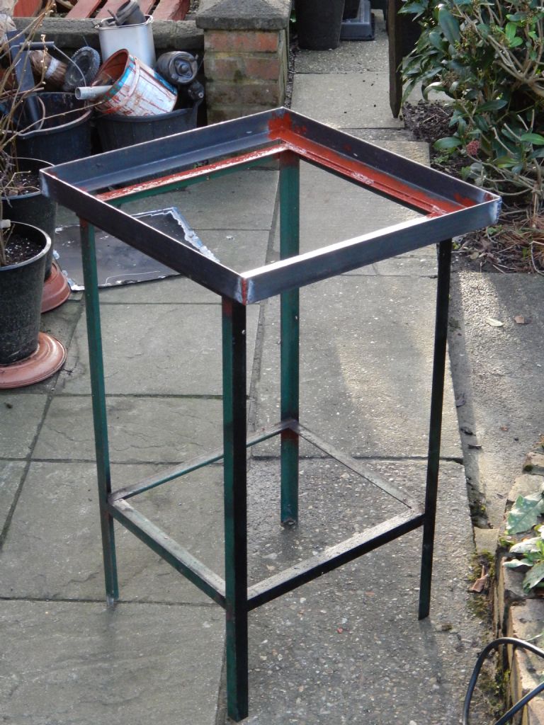

Here is the frame work have made wanted it small so it would not take up so much space.

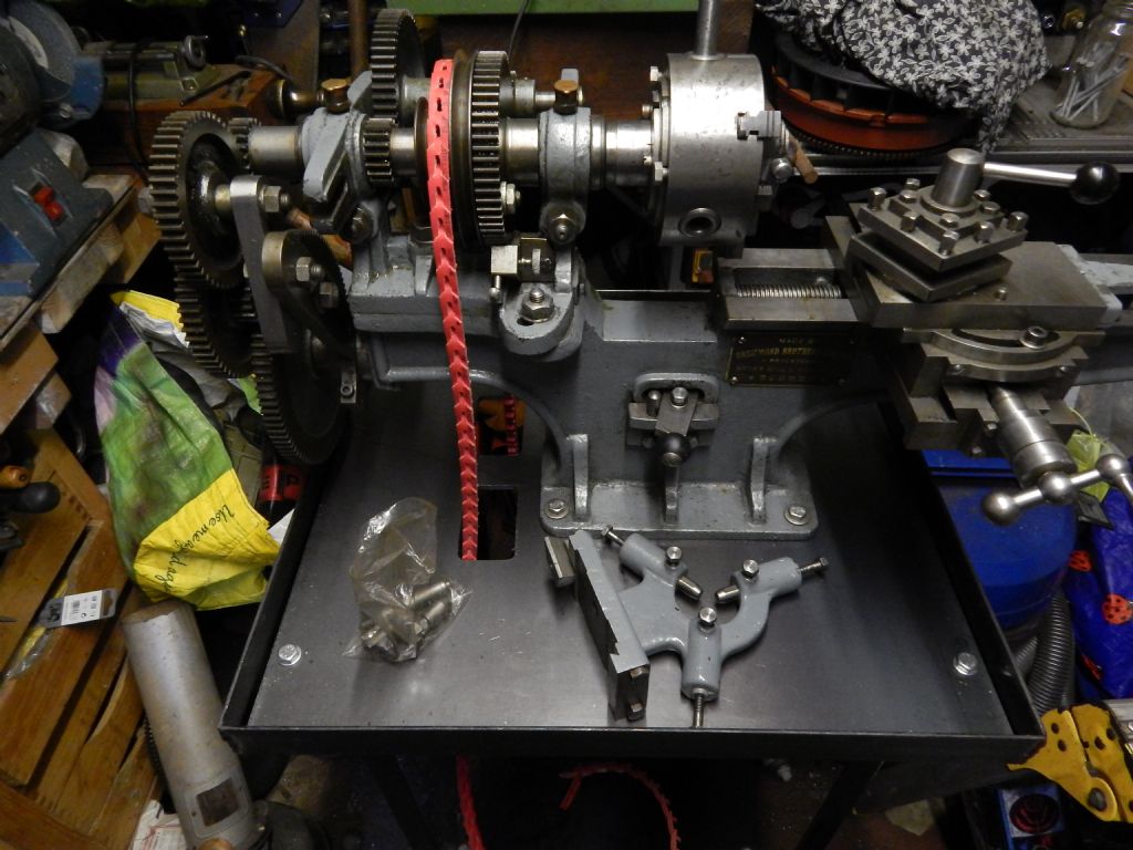

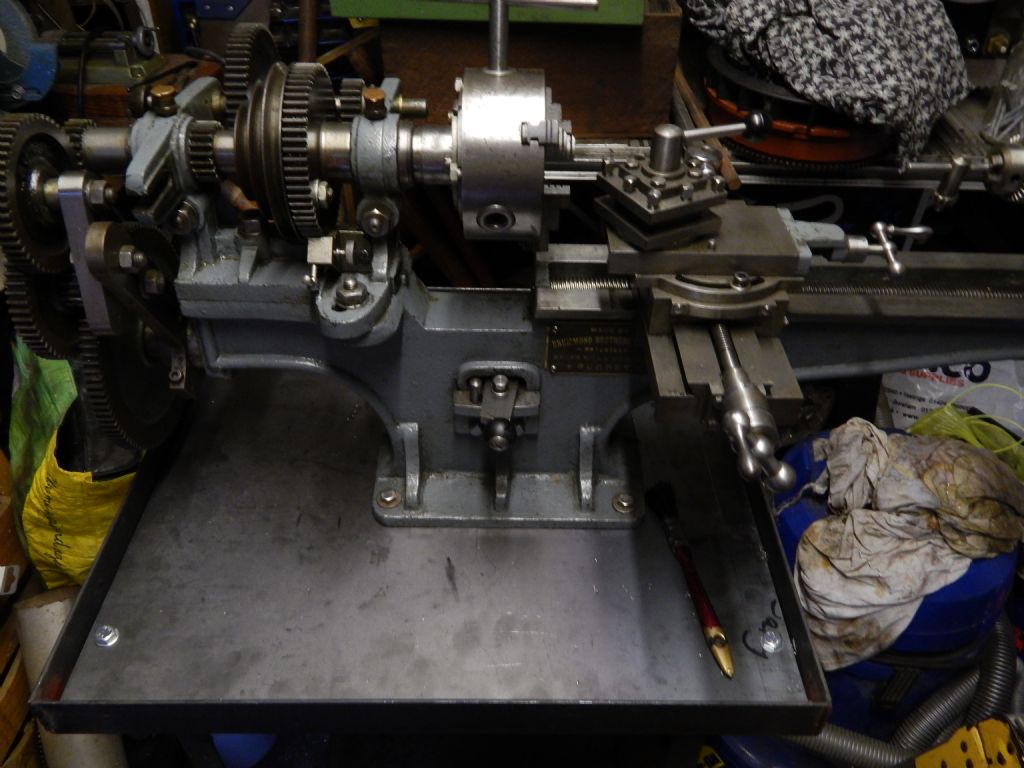

Have top plate mounted and lathe mounted . Have to work out the size of the belt holes am going for two i think as it will maintain some structure . I hope someone can tell me the size of the original cuts into the bed on the original stand to take this there is lots of pictures on http://www.lathes.co.uk/drummond/ but no dimensions of the slots to take the belts sadly.
Martin Newbold11/01/2016 15:28:33
415 forum posts
240 photos
This is as far as I have got . Cut some holes not sure they don't want to be bigger. Need motor next and a system to release and tension drive does anytone have any ideas please?dscn5032.jpg

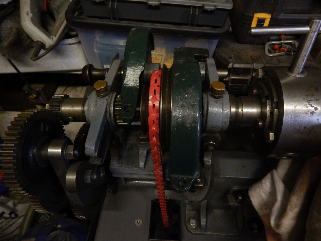

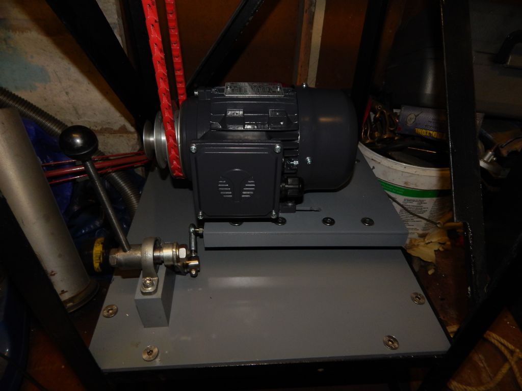

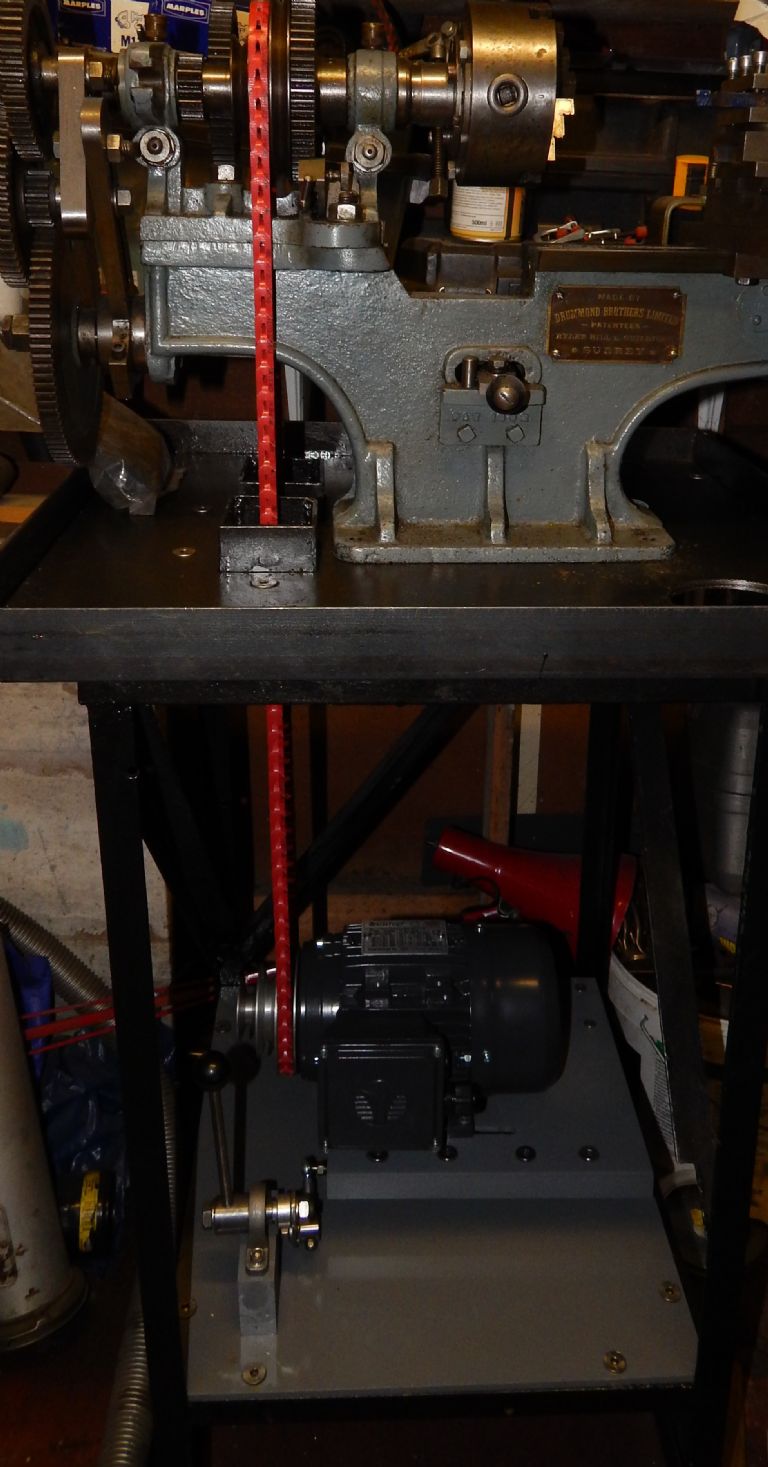

240 photos
Ok have been quite making a motor plate and obtaining a motor these are now installed am looking for anyone who knows where I can obtain a small idler pulley with bearings in the UK as the smaller pulley on the bottom motor is allowing the belt to catch on the lathe. Is there any reason why I cant put the inverter in the door I want to make for the bottom.
http://www.model-engineer.co.uk/albums/member_photo.asp?a=39532&p=660215dscn5490.jpg
Martin Newbold09/03/2016 13:25:26
415 forum posts
240 photos
As you can see the belt is good, but need to make a tensioner to bring the belt away from the lathe so it does not rub on the side and wear through the belt. Yes I know the gears will rotate and they need a cover Health and Safety
Gordon W09/03/2016 14:25:12
2011 forum posts
A very good and free idler pulley can be got from any repair garage- tensioner pullies for camshaft belts
Ian S C11/03/2016 08:30:35
avatar
7468 forum posts
230 photos
I would check the speed you need, I imagine the motor you have is a 4 pole motor, 1450 rpm (aprox), I have a feeling that there should be a jack shaft in there to bring the speed down, probably about 3:1 reduction, someone with a Drummond might comment, you have done a good job.
