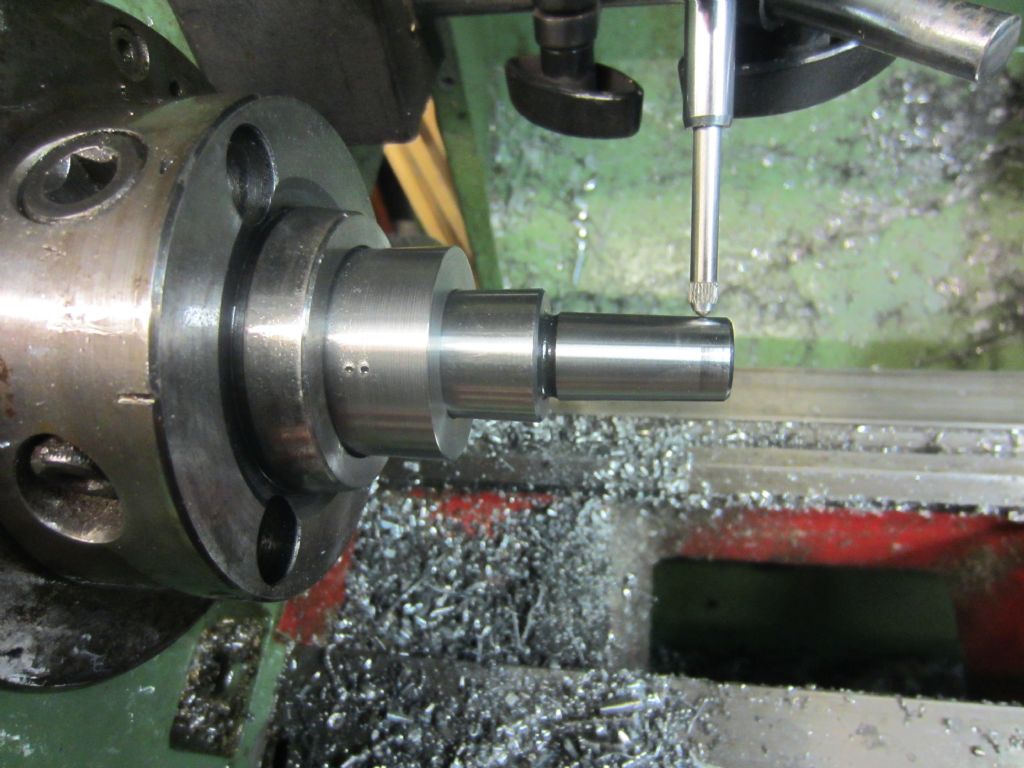

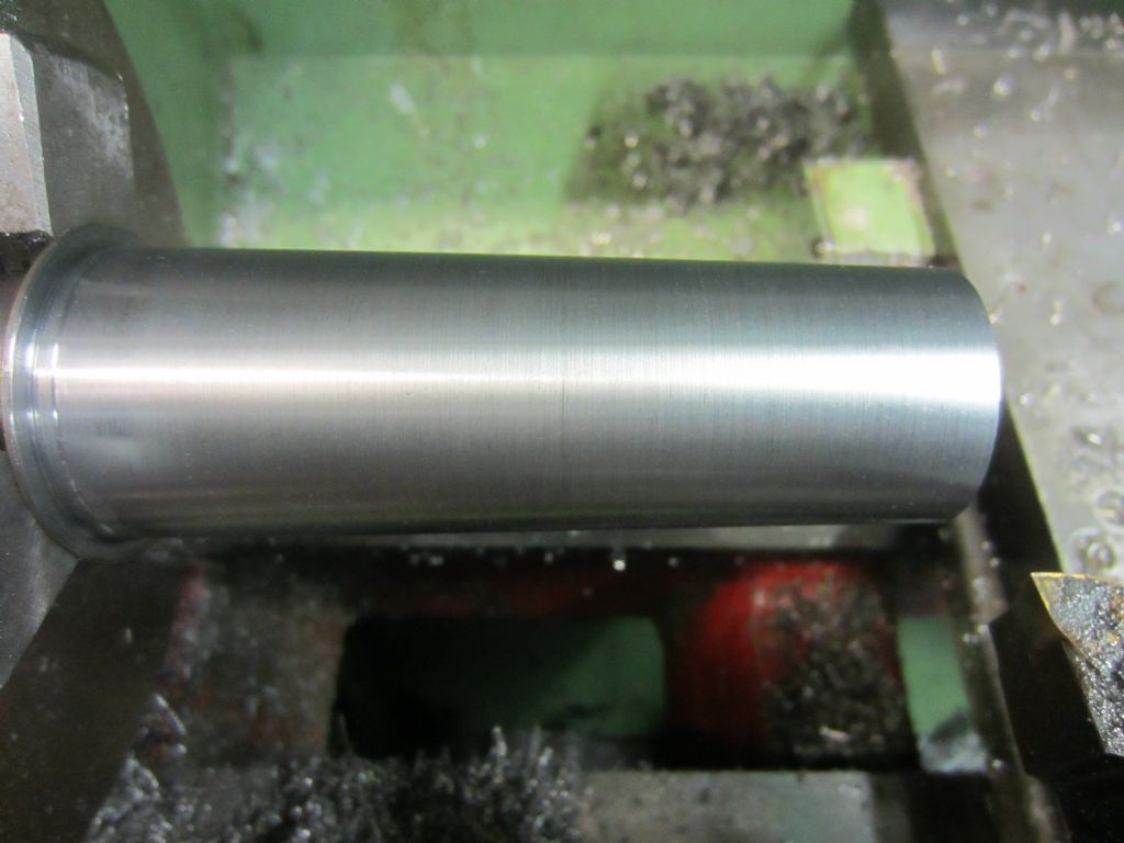

Joe Page06/01/2016 19:56:44
37 forum posts
10 photos

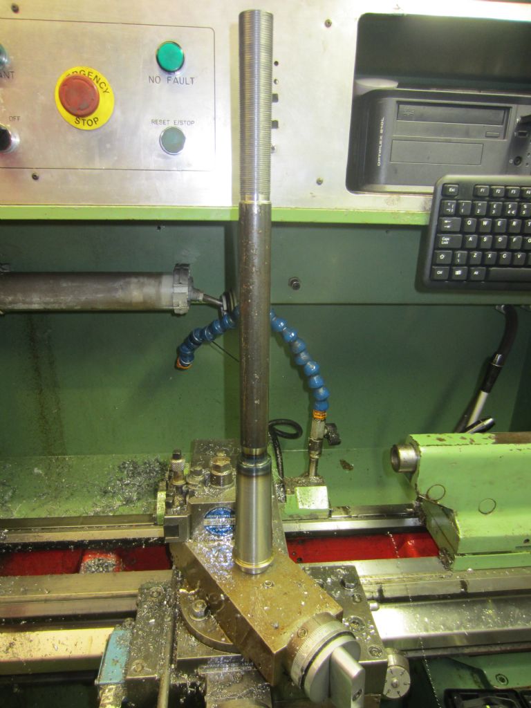

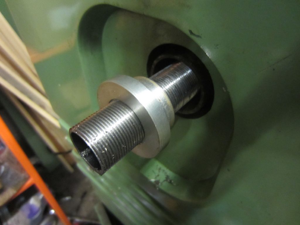

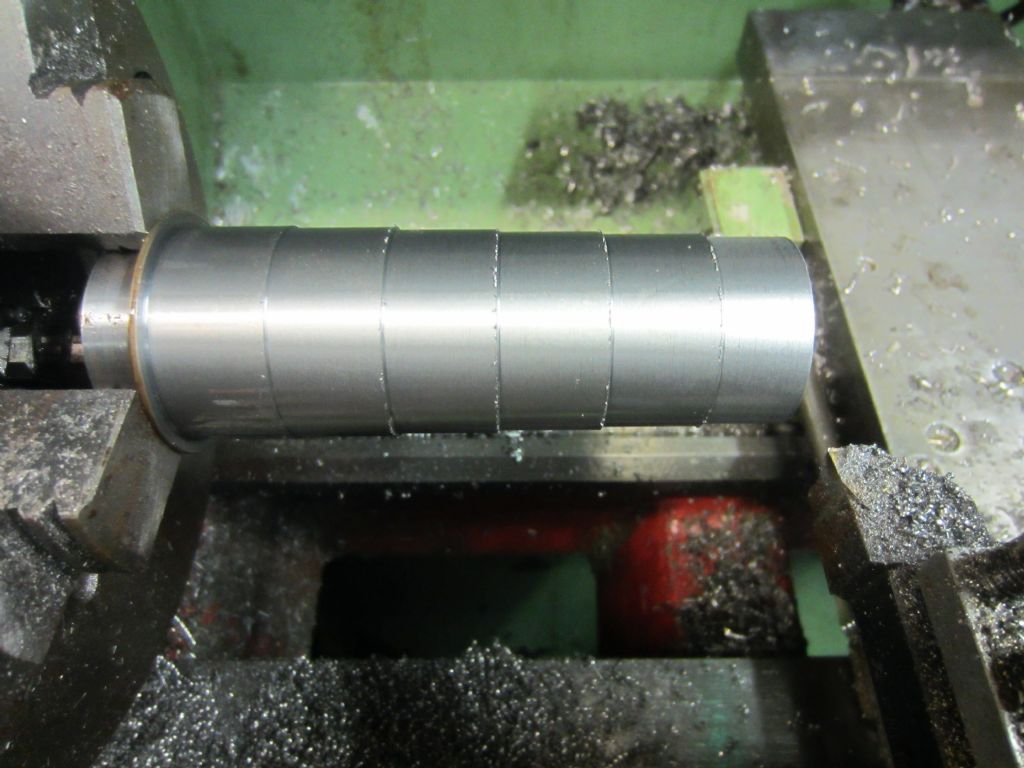

Decided to start making an adapter today, I instead have gone for two draw bars. A tube like one for the MT4.5 adapter and then a rod drawbar to run down the middle for the MT3 adapters. I wanted to machine the MT3 bore with the adapter inserted into the headstock, hence the reason for two drawbars. Used the CNC to get the angle right and it turned out perfect, 2000rpm, 12mm hold, 110mm over hang, 0.6mm cut really didn't feel all that safe :s.
Just got to make a nut and machine the other side, piccys:-

Posted by Joe Page on 06/01/2016 19:56:44:
Wow, you are more of a man than me - or perhaps your rubber pants are stronger. Holding on by the tips of the 3-jaw with 110mm overhang - hope you weren't standing alongside when it was cutting. That's another benefit of CNC control I suppose - you can stand outside the shed while it does the business.

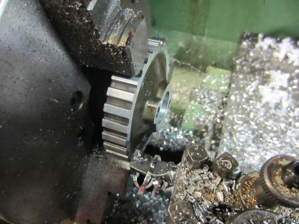

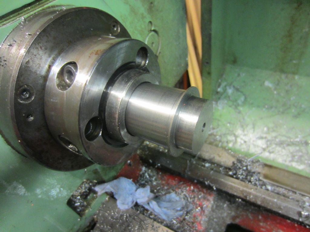

Joe Page07/01/2016 18:23:07
37 forum posts
10 photos
Muzzer - stood with a thick Perspex sheet in front of me with one hand and the other hand on the emergency stop, It did scare me so I haven't run it that fast since.
Dave - The taper is 1:19.2307. I started the big end a mill above the nose bore and tapered down a mill below the bore. So the big end was 39.2mm tapering down to 34mm at a length of 100mm (39.2 - (100/19.2307). I admit I'm not happy with how little contact area there is in the nose, not sure what the Colchester is like, but the Harrison M250 is only 15mm long, about a 30mm gap and then a little more of a taper.
Turns out I had a MT3 arbor for a drill chuck, has a M12 thread in back thinking.

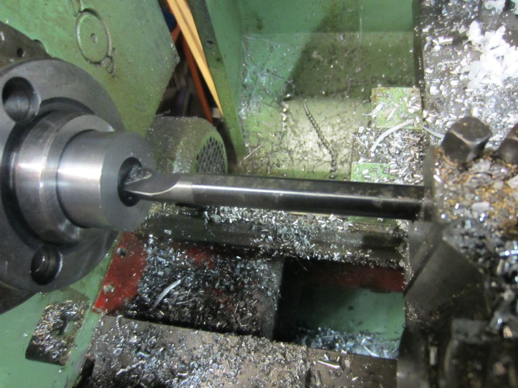

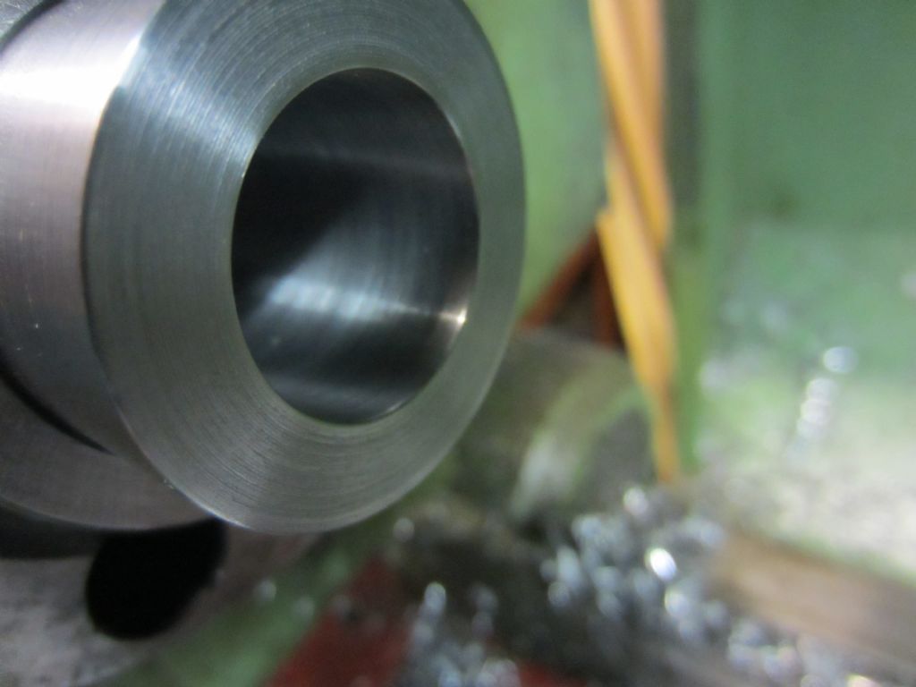

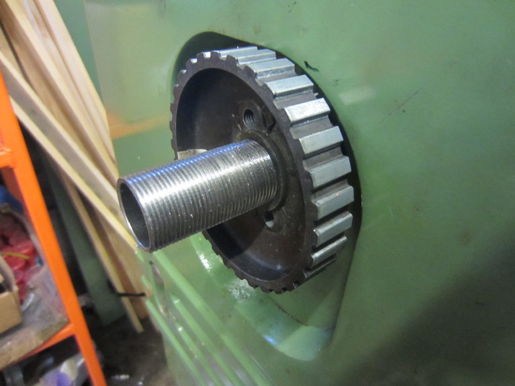

Anyway as for the adapter, made a nut for the draw bar from a top end timing pulley, magnesium alloy so it seems to have worked out ok because the threads aren't sticky, saved some time instead turning and milling a nut. Drilled out the adapter nose to 20mm as the smaller end of MT3 is 20mm, just to allow tung types to fit down it. Then bored it out using aluminium inserts and the final pass was 240rpm, 0.5mm at 20mm/min. The boring bar was only turning 90mm inside but had to stick it out 120mm due to the carriage hitting it's limit.
Overall I'm really happy the way it turned out, taper came out perfect and no mistakes, yeay. Piccy's:-
