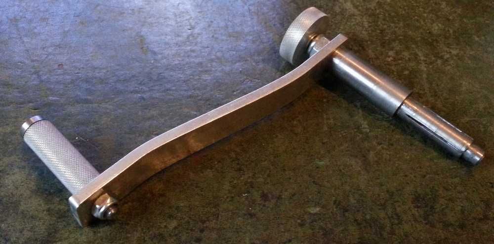

Gordon Brown 103/01/2016 14:52:15
48 forum posts
2 photos
Having given some thought to what I was doing wrong I realized that John Stevenson was at least partly right, I was disengaging the half nuts and winding back, but I was using the thread dial indicator on the carriage as I had done when I last cut some imperial threads. Being a raw beginner I had assumed this would work with metric threads, which it clearly doesn't. Winding back by hand was very hard work as the back gears were engaged and I didn't have a spindle driving handle. So, I've spent the weekend making a handle from my own design and it works a treat. The design is my own with ideas from photos I found trawling the net and it gave me the opportunity to use the knurling tool and tailstock die holder I was given for Christmas. This should make life a good deal easier!
As yet I haven't attempted to redo the exhaust adapter as I'm still considering the best angle to make this as I want to keep the silencer completely within the cowl of the aircraft and as I now have my lathe sorted I may even make a complete new silencer. For anyone who is interested the aircraft is a 71 inch span Mitsubishi Zero powered by an ASP 120 four stroke, it's a big b***er, should weigh around 12 pounds ready to fly
As I've said, I'm a complete beginner having bought the lathe some time ago to make parts for rc aircraft and it's taken ages to get to this point and I'm learning from that very hard teacher, trial and error, mixed in with advice from forums and books. Great fun though! The lathe was an EBay purchase, but I had the opportunity to inspect before buying as it was just a few miles away, and £300 for a decent ML7 with loads of accessories and tools struck me as a good deal. My biggest problem I sorted by myself; after I'd had the lathe a couple of months it started to chatter when cutting and this got progressively worse until I was despairing of ever being able to use it. I checked the bearings (plain ones), negligible play, carriage, cross and top slides were as rock solid as could be, lathe well bolted down and level, no significant vibration from motor, etc, etc. Having left it alone for a couple of months I went back to it last week and whilst checking the spindle I noticed that the locking collar on the end of the spindle was loose, giving about 20 thou of end float. Nipped it up to give about 0.5 thou float and lo and behold the chattering has gone completely. Not something I'm likely to miss again!
Many thanks for all the replies, if I still have problems when I redo the adapter I'll be sure to use some of the suggestions.

Posted by Gordon Brown 1 on 03/01/2016 14:52:15:
..... Winding back by hand was very hard work as the back gears were engaged and I didn't have a spindle driving handle.
You can disengage the back gear and wind the mandrel back by hand. The back gear is not involved in the gear train from the end of the mandrel to the leadscrew. Should make life a lot easier, even with your very nicely made handle.
Edited By Hopper on 04/01/2016 08:57:41

Gordon Brown 104/01/2016 09:07:27
48 forum posts
2 photos
I'm using the back gear to keep the speed low, would it be better just to cut the thread by turning the spindle using the handle? It's only a short length of thread, about 3/4 inch long.
Michael Gilligan04/01/2016 09:09:38
avatar
23121 forum posts
1360 photos
Posted by Gordon Brown 1 on 04/01/2016 09:07:27:
Yes
