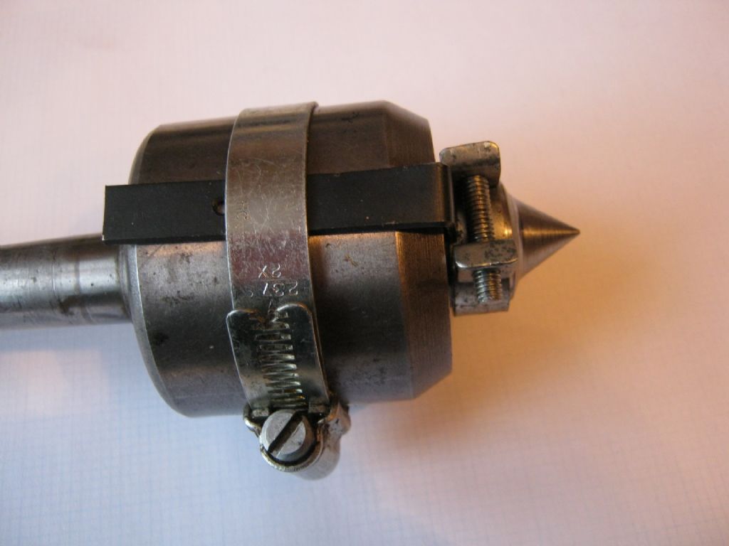

Can anyone please tell me the best way to reprofile the tip of a revolving centre which has had a hard life?

I have done this with a tool post Grinder in the past, I bet it could be done with a dremel or similar also held in the tool post.

Lock the centre and regrind it in the headstock.

How do you lock a revolving centre?

For grinding, the forces should be quite low so an optimally sized lump of weld will do it easily, more practical though might be masking tape.
Piling up thin thread soaked in something sticky where the revolving part meets the stationary bit should do the job too (and keep grinding dust out)

I can suggest two possibilities:
My GMT brand revolving centre point has a major diameter the same as the body and it might be possible to lock the two elements together with some form of clamp or perhaps a winding of tape.
My "best" RC is a Gepy which has an oil hole closed by a small screw and I wondered whether temporarily substituting a setscrew would do the trick; this was the method adopted by Lawrence Sparey in the design for a shop-made item in "The Amateur's Lathe".
Does anyone know how the makers do this?

mick H31/10/2015 14:44:37
795 forum posts
34 photos
I had a go at it yesterday and achieved (by my standards) a half reasonable result using a carbide tool and the set up in the picture. Unfortunately I lost about 1/4" of the tip which crumbled away....probably due to inaccurate centreing of the tool. I any event, it is in better shape than it was!revolving centre.jpg
