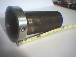

Displacer hot endAlan doesn't say which lathe he is using, if he has a reasonably large lathe, with a good amount of HP, drill a pilot hole just over the thickness of the web of the final drill, then straight in full size. But if he has a small lathe, Myford or smaller, he might not be able to get the larger size drills to work, so boring might be the way to go.
I think this was made from 304 stainless, the bloke at the ware house where I got the steel from reckoned I'd be pushing my luck  but as it was the only bit of stainless in the scrap bin he gave it to me to have a go at.  It has a bore of 30 mm, and a 32 tpi thead in the open end.
