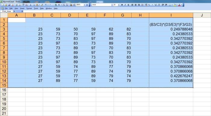

I've been goofing around with a c (c++?) package and tried to find how many perms under 100 teeth could hit 25.4 tpi
accuracy is 6 decimal places (float format)
Might be handy for someone, there's more than you'd think
The outputs are headstock->banjo->banjo->leadscrew
So the top one is:
headstock 23 then 59/50(in/out) 59/62(in/out) leadscrew 82

Something seriously wrong with the program to get these results.
I have taken the first 12 entries and run them thru a spreadsheet. Don't know what pitch screw was going to be used so just done the driver over driven times driver over driven, times driver over driven.
Even if this is wrong I should get the same answer for each line but I don't.
Ady108/09/2015 01:27:30
avatar
6137 forum posts
893 photos
But the missing piece is - what pitch leadscrew? Presumably a metric one?
tsk tsk tsk TPI is 8, sorry 'bout that
Found a match 25.400000 n[23.000000] n[73.000000] n[89.000000] n[97.000000] n[70.000000] n[83.000000]
Found a match 25.400000 n[23.000000] n[73.000000] n[89.000000] n[97.000000] n[83.000000] n[70.000000]
First one:
(73/89)*23=18.8651etc
(97/70)*18.8651=26.1417etc
83/26.1417etc=3.17499
3.17499*8tpi=25.3999
Second one:
(97/83)*18.8651=22.0472
70/22.0472=3.17499
duh
I got my outputs and my inputs printout muddled up, so it's in the correct order for calculating, but the compound gears need to be swapped round for constructing on the banjo
*sigh*
So the top one is:
headstock 23 then 50/59(in/out) 62/59(in/out) leadscrew 82
Edited By Ady1 on 08/09/2015 01:46:24
Ady108/09/2015 02:04:32
avatar
6137 forum posts
893 photos
Also some have the same issue with teh first two gears eg
59-23, 50-59, 62-82 can't be the same as
23-59, 50-59, 62-82 can it?
59 23-50 59-62 82
23 59-50 59-62 82
first:
(23/50)*59=27.14
(59/62)*27.14=25.82677
82/25.82677=3.17499
3.17499*8tpi=25.3999tpi
second:
(59/50)*23=27.14
82/25.82677=3.17499
3.17499*8=25.3999tpi
It all seems ok to me, (only playing about though)

Trouble is if you are going to the trouble of making non standard change wheels like 23 and 59 you might as well do a 127 and have done with it.
I remember doing a program for the BBC computer (2 MHz clock) and waiting until 3 am for it to beep me awake at 3 am. Now the biggest wait is for the bloated operating system to load.
Ady108/09/2015 10:23:45
avatar
6137 forum posts
893 photos
A 127 is gigantic and a real pain to make, ideally, nothing over 75 would be best for a hobby lathe
I can feel another c project coming on.....
23 is easy, I already have a 46. 59 however would need a banjo permutation.
I wonder if...we could go backwards from the leadscrew to cut awkward gears like 59 at the headstock end

As I can't load software on my company computer I am restricted to VB in Excel. 'Spose I should buy myself a new box but that's the cost of lots of more tools.

Ady113/10/2015 11:41:51
avatar
6137 forum posts
893 photos
Introducing an "allowable error" makes things miles easier
Using a gearset of
20 25 30 35 40 46 50 55 60 63 65
for 25.4tpi on an 8tpi leadscrew and 0.001 error gives almost 400 returns
Found a match 25.396826 n[63.000000] n[20.000000] n[60.000000] n[30.000000] n[40.000000] n[50.000000]
Found a match 25.396824 n[63.000000] n[20.000000] n[60.000000] n[30.000000] n[50.000000] n[40.000000]
Found a match 25.396826 n[63.000000] n[25.000000] n[60.000000] n[30.000000] n[50.000000] n[50.000000]
Found a match 25.396826 n[63.000000] n[30.000000] n[60.000000] n[20.000000] n[40.000000] n[50.000000]
Found a match 25.396824 n[63.000000] n[30.000000] n[60.000000] n[20.000000] n[50.000000] n[40.000000]
Found a match 25.396826 n[63.000000] n[30.000000] n[60.000000] n[25.000000] n[50.000000] n[50.000000]
Found a match 25.396826 n[63.000000] n[30.000000] n[60.000000] n[30.000000] n[50.000000] n[60.000000]
Found a match 25.396826 n[63.000000] n[30.000000] n[60.000000] n[30.000000] n[60.000000] n[50.000000]
Found a match 25.401600 n[63.000000] n[25.000000] n[63.000000] n[50.000000] n[63.000000] n[63.000000]
Found a match 25.401600 n[63.000000] n[50.000000] n[63.000000] n[25.000000] n[63.000000] n[63.000000]
Found a match 25.401600 n[65.000000] n[25.000000] n[63.000000] n[50.000000] n[63.000000] n[65.000000]
Found a match 25.401600 n[65.000000] n[25.000000] n[63.000000] n[50.000000] n[65.000000] n[63.000000]
Found a match 25.401600 n[65.000000] n[50.000000] n[63.000000] n[25.000000] n[63.000000] n[65.000000]
Found a match 25.401600 n[65.000000] n[50.000000] n[63.000000] n[25.000000] n[65.000000] n[63.000000]
Found a match 25.401600 n[65.000000] n[25.000000] n[65.000000] n[50.000000] n[63.000000] n[63.000000]
Found a match 25.401600 n[65.000000] n[50.000000] n[65.000000] n[25.000000] n[63.000000] n[63.000000]
