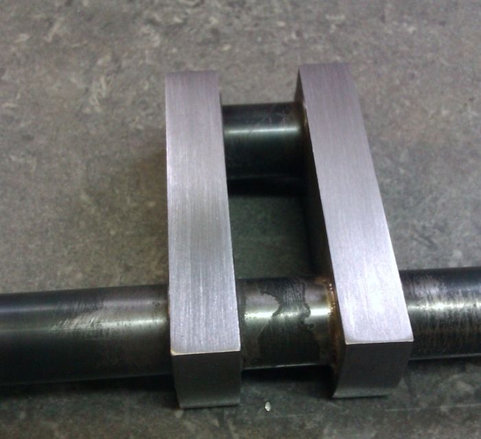

I have just fabricated a Stuart 10V crankshaft. The short pin and the axle were sliding fits in the web holes and cleaned with acetone. My intuition is that Loctite 638 should hold it satisfactorily.
However, the plan indicates that pinning is expected.
I have searched the site and found good information, particularly from Ramon Wilson, but please could someone with experience advise me on the following:
(a) Is 1.6 mm mild steel (panel pin) a suitable diameter?
(b) The Stuart plan shows the pins extending through the “flat side edges” of the web. Would it not be better to go through the “curved ends” of the web?
(c) Do pins extend right through the diameter of the shafts into the web on the other side?
(d) Do pins need an interference fit such that they have to be inserted with firm taps of a hammer or will a sliding fit with Loctite suffice?

a. That would be about right, just use a drill that gives a close fit to what you have to hand
b, Better to use 4 pins that go from side to side rather than two long ones end to end
c, Drill the hole right through until it breaks out the other side of the web
d, they don't want to be a sloppy fit but then again should not need a 2lbs lump hammer to drive them in, light push fit is what to aim for.
e, leave the pinds 1/16" proud each end and then lightly pein them over with a hammer which will expand them into teh holes and eliminate slack and when filed flush should become invisible.
J

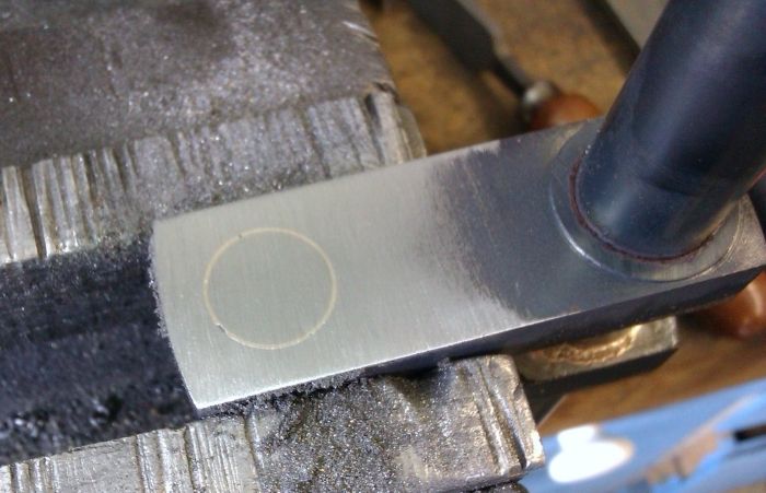

Rod, I suppose it's belts and braces. I have read too many times on forums of loctited crankshafts letting go and slipping or pressed fitted ones not going together true or all the way. I generally prefer to silver solder and the pins add nothing to the alighnment Neil as they will not affect the position of an already soldered joint being drilled after soldering, they are just there incase the solder may look OK on the outside but has not penitrated the joint.
You also need to bear in mind that a lot of my crankshafts are for large hit & miss engines which have quite a punch when they fire and that puts a lot more load into the joints than the relatively constant force from a steam engine.
The other thing to watch with Neils 0.001-0.003" clearance is that of keeping things lined up when assembling, some of my cranks can be over 12" long and that 0.003" play in the middle could be 0.010 - 0.015" at the ends
Ron, one trick when soldering up cranks is to put a light CSK on the side of the web that will be away from the shaft/pin and feed your solder in from that edge, it keeps the solder off the running surfaces so less clean up and you should be left with a neat ring of solder filling teh CSK and hopefully penitrating teh joint.

Inner and outer cheeks are just draw filed and if the pin or journals need cleaning up then just some work fine emery is all that I use, trick is to keep the solder off the bits where you don't want it.
