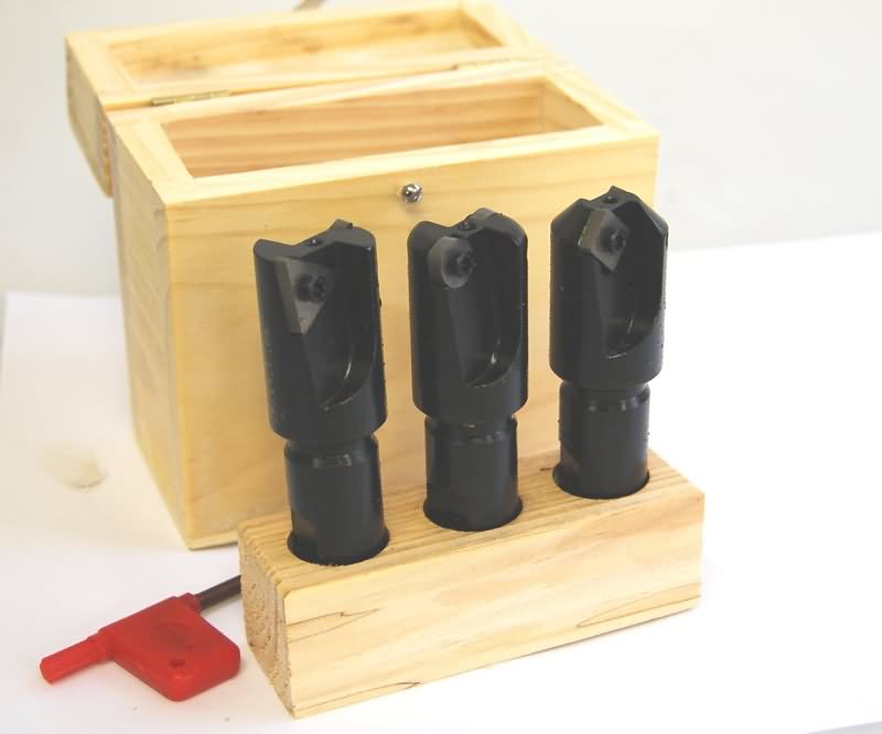

I use similar ones on the vertical milling machine, mine are 16 mm per side, I also use them in the lathe.

Posted by Muzzer on 13/07/2015 12:59:42:
Are you convinced that your milling cutters are like the photo, rather than the illustration? The common or garden indexable milling cutters from Glanze (Chronos) have positive top rake inserts.
I have the little hogger set from Chronos. One has round inserts, one square and the other triangular and all the inserts are double sided. I checked the website but the pictures aren't clear.
**LINK**
I only usually use the face mill but it works really well on my mill and as said it's quite cheap to run as you get six edges per insert before it needs replacing and only two inserts in the cutter.

Not the best of pictures but you can just see the inserts are double sided.
Vic14/07/2015 11:55:19
3453 forum posts
23 photos
Found a better picture.
