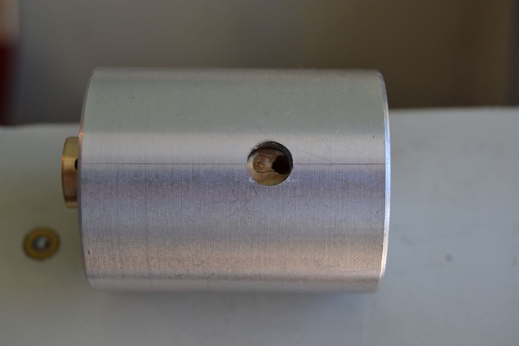

Firstly I decided to machine the cylinder block / steam chest, I didn't have a piece of brass big enough to hand so I settled for aluminium (It's unlikely the engine will ever see live steam so I figured aluminium will do for compressed air).
Block turned and faced to size then power piston bore done.
Steam chest bore done, I decided to make this slightly larger diameter than the plans as I think that may prove more forgiving at my skill level.
Ready to begin drilling inlet port.
Drilled through as far as power cylinder, I was a bit relieved at this point. With my limited tools and experience I wasn't certain how parallel the bores were etc. However once the inlet was drilled through my scriber seems to suggest they are reasonably true.
I decided to omit mounting holes for the cylinder at this point as I'm not yet certain how I'll go about it but will probably deviate from the plan.

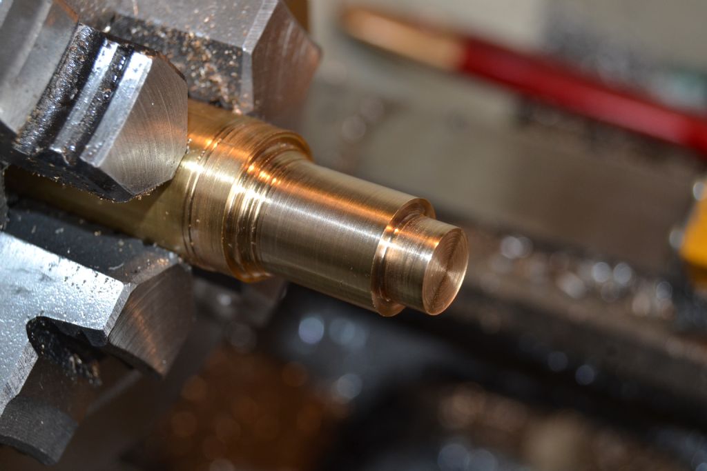

So - I decided on the piston next. This time I had a suitable piece of brass
I did damage the first piston when I turned it around in the chuck but had better luck second time
I decided to cut in a couple of very small oil rings that aren't on the plan but I thought they may help me get a better airtight seal.

Although the plans have this as a vertical engine I'd prefer to have it as a horizontal so have been doing a lot of thinking how I might best go about it. Part reason I didn't try a 'wobbler' as a first project was that without access to a milling machine I didn't feel I could reliably file the necessary flat face by hand with sufficient accuracy.
After some helpful advice from other members here they suggested I could face off a piece placed a cross the lathe chuck if I was careful about it.
I decided I wanted to bottom mount the cylinder block and reasoned the only way was to face off in the way others had suggested, with the intention of bolting it to a plate. The cylinder walls are fairly thin and bottom mounting seemed the best option.
I decided to have a test run with a piece of similar sized aluminium and sure enough it worked with ease. At least now I know that till I get a mill it is possible to do very basic 'milling' in the lathe. As this was only a test piece I didn't go to the trouble of lining it up properly but you get the idea.
I figured that lining up would be a problem but with the use of parallels and a few faint scribe markings that were still left from earlier drilling operations I could just about manage. I used the tool point to align with the scribe markings and rotate the work by hand in the chuck 180* whilst not moving the tool.
In order to get access to the scribe markings along the centre line I needed the work out of the chuck slightly beyond its diameter so it's actually only being held firmly by the 2 flat ends with the other 2 chuck jaws gently touching the curved sides. I realise that's far from ideal but the intention is to take light cuts on a soft material and I have got a very firm grip of the flat ends of the work.
Success ! - A bit of filing and tidying up to remove a few minor scrapes and chuck marks and also seems to be ok.
