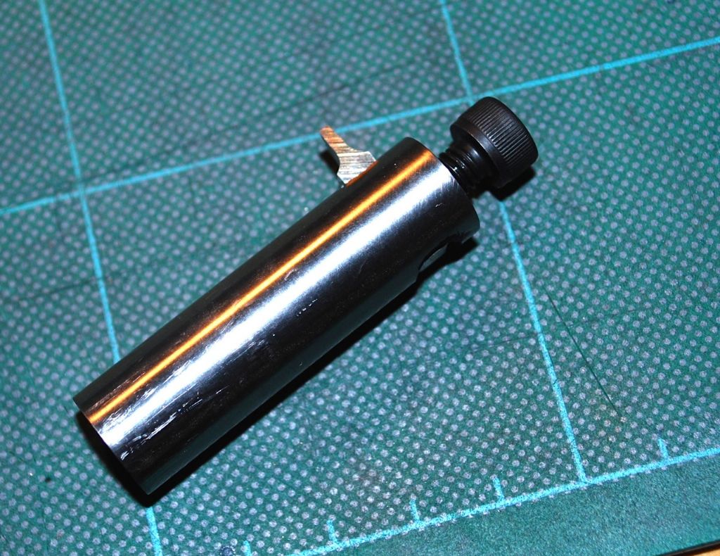

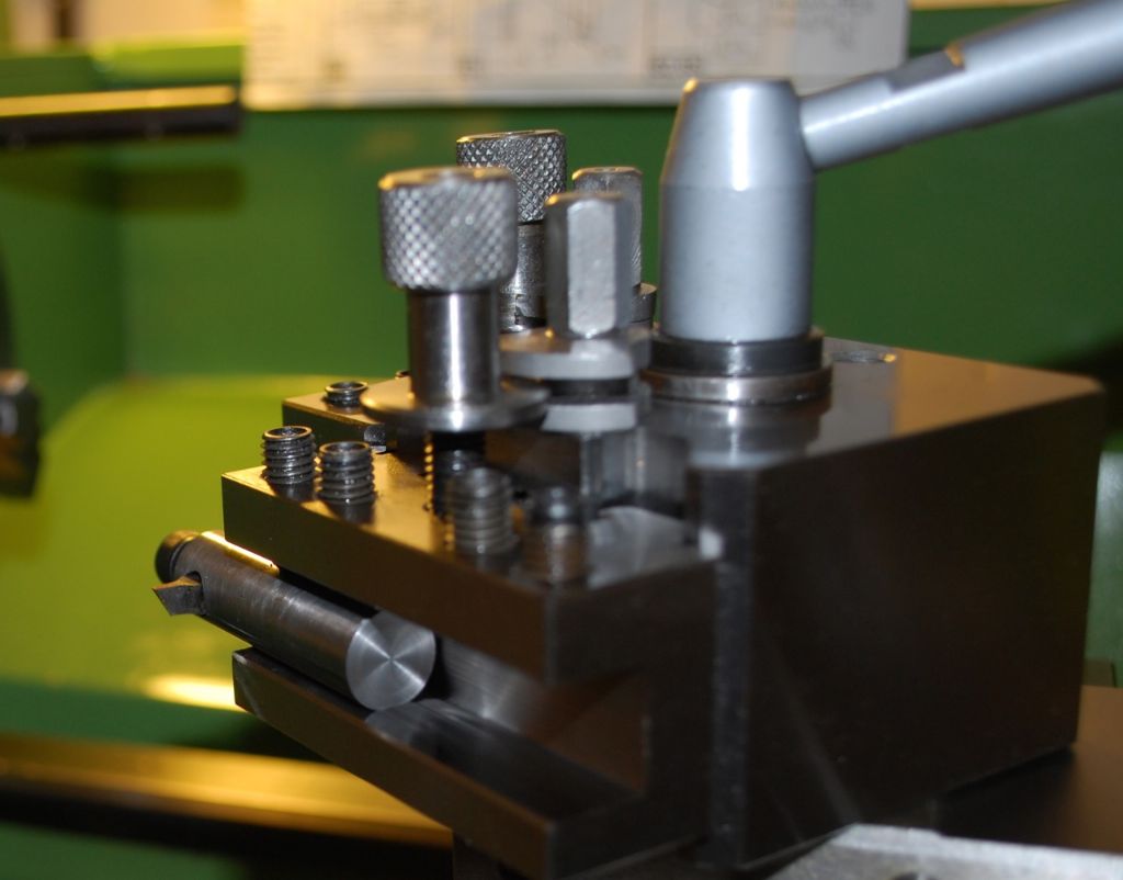

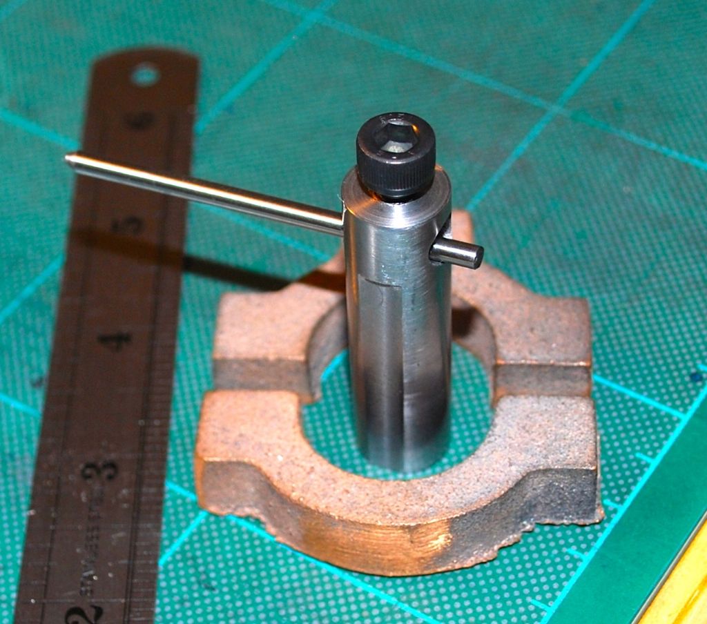

11/11/2015 10:07:45

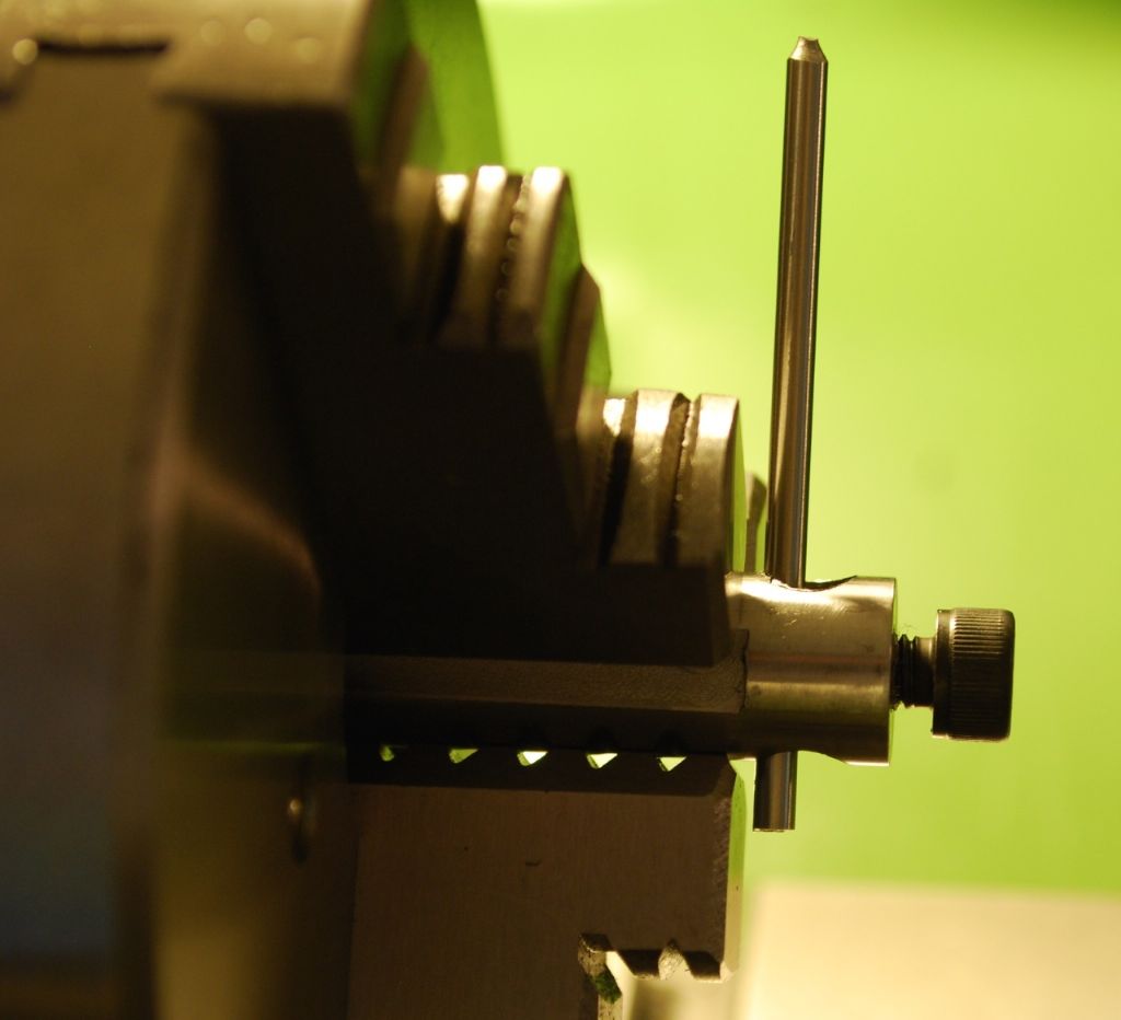

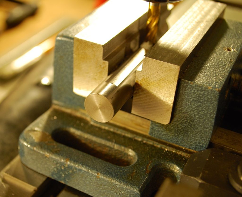

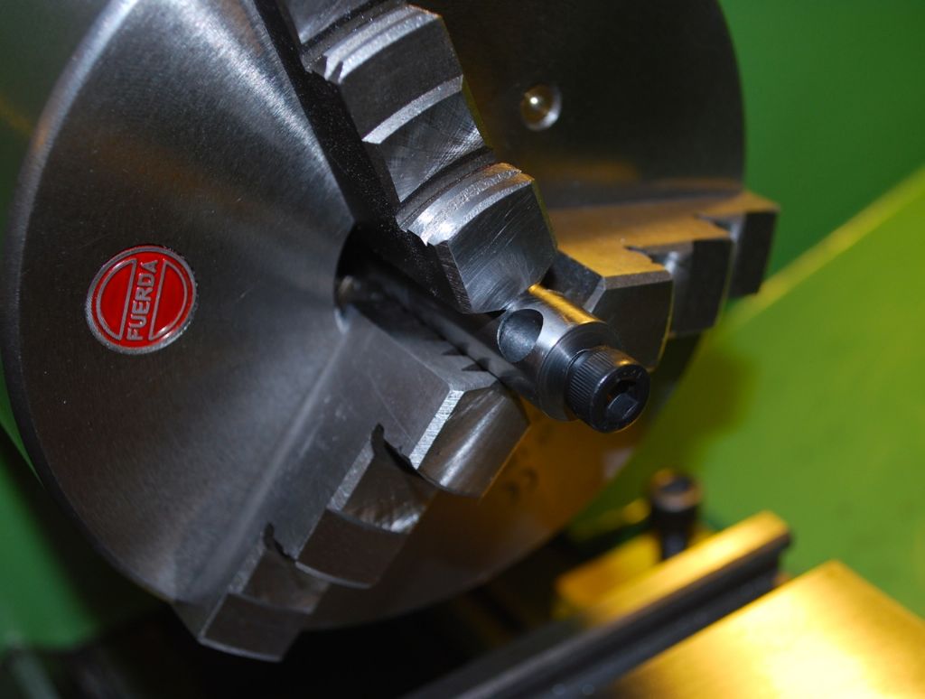

The Tool Holder for the internal groove in the Eccentric Strap, (I've probably put too much detail here for this..).
This I've not been too fussy over using a short left over piece of bar that I had - not ideal really but its saved turning down a longer 1" diameter, which seemed a bit wasteful, I've not even turned the outside diameter..
Starting the Tool Holder by first putting on a small flat with the Mill
Then rotating the flat through 90 degrees for drilling the cross hole for the tool piece.
and then onto the lathe for drilling and tapping for an M6 Cap Head screw
it should enable a variety of tool bit thickness to be held - iI'll probably grind the tool for the strap groove from a larger and rectangular section of tool steel. Hopefully not too difficult to do just some front and side clearances and no top rake for the Gun Metal strap..
it would have been more useful I guess to have made a longer one - I need to order in some more spare bar stock again..
The finished tool holder and the Eccentric Strap castings as supplied - Gun metal. Hopefully it will work ok..
tomorrow I'll have a go at making the tool bit..
Cheers
Garry

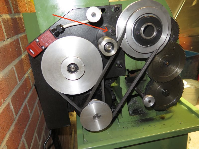

08/11/2015 17:59:06
Hi David
Sorry I don't know which model 250 you have - I have a manual for the latest 250V inverter model if you need any info copying and posting here re belt positions etc. The roller (i.e. tension) is adjusted by loosing the bolt arrowed as Michael says...
Hope this helps
Cheers
Garry

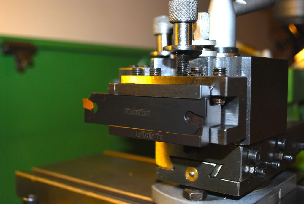

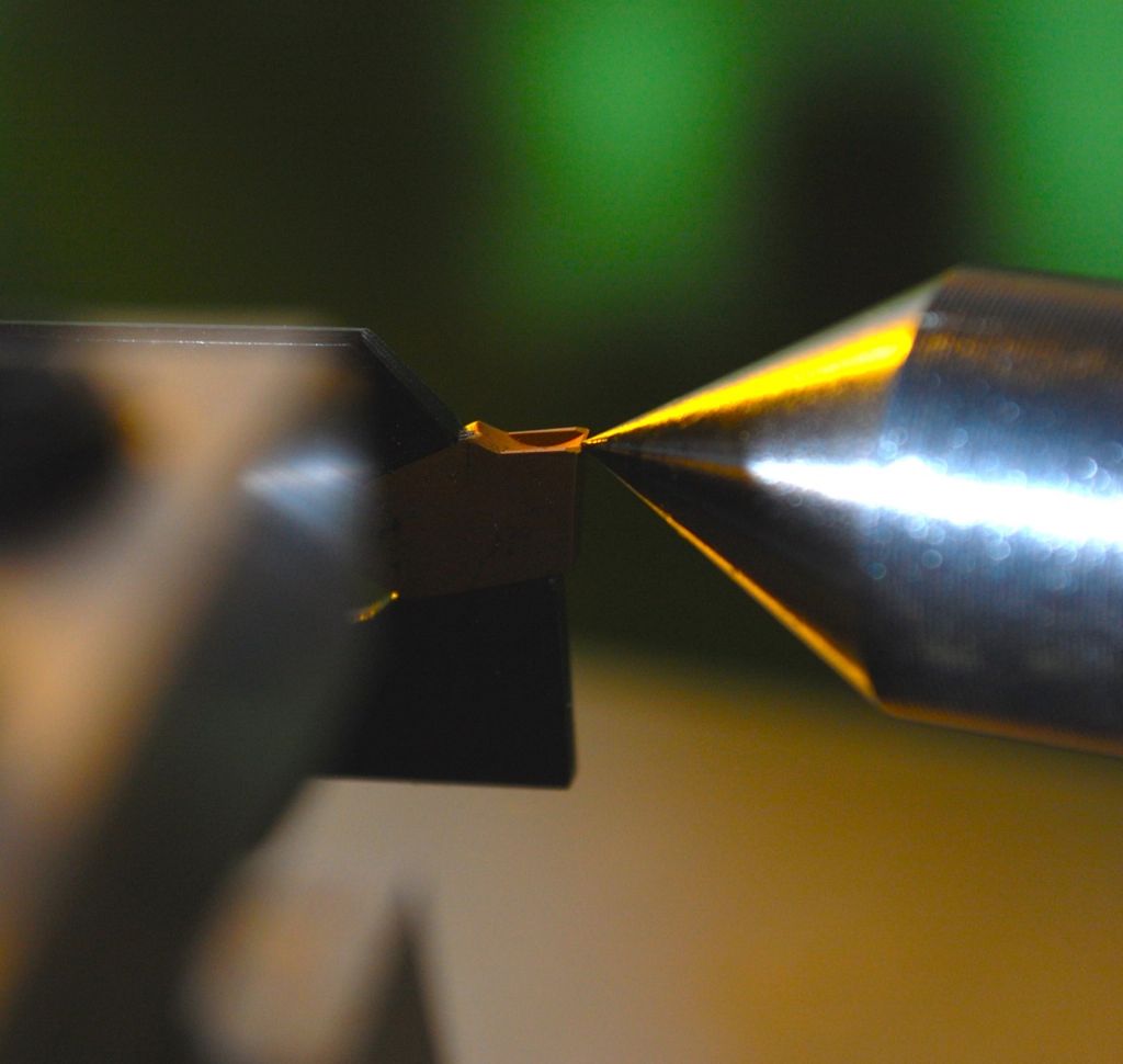

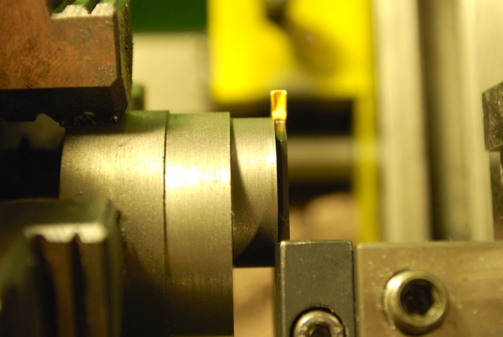

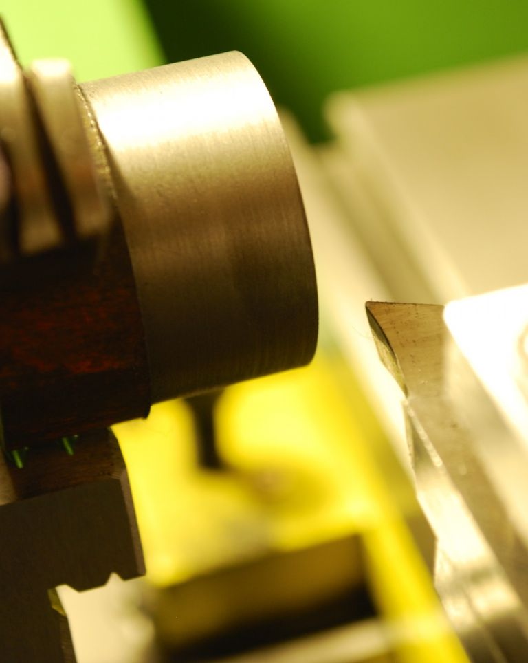

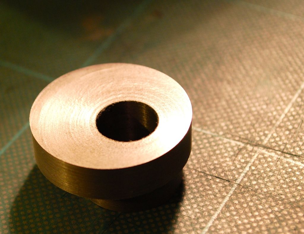

08/11/2015 14:37:14
This is more me marking a bit of a milestone than a build update really - I don't recommend that anyone watches the video as it goes on a bit and then some more - (I've probably got the settings wrong as well and was just an experiment until I get some more practice). Its the first time I've tried parting off under power and I thought that the eccentric sheave with its offset diameter and the offset bore would be as good a test as I'm likely to find (the bar is about 1 3/4" cast iron). (I don't have a pump coolant system).
I wouldn't have even thought to try this with one of my 'standard' parting tools, but the Glanze I've always found to be superb when hand feeding and have been wanting to try under power for ages, also wasn't sure if the lathe was too small to even try it given some of the horror 'parting off stories' I've seen..
Setting the tool position before starting..
This is just something to maybe look back on as another first (for me) - don't watch its way too long..!
The cut I thought was great, I always seem to get a burr at the end sometimes quite big when I've been hand feeding but not here under power - there was a slight wafer thin coil left around the hole and which came away in one piece with my fingers. I may be converted to this way now.. I used the slowest feed rate on the lathe, I'm sure on a true running diameter I could have gone faster - not that matters anyways...
This was straight after the cut had finished, just the thin 'coil' removed around the bore and cleaned with a rag - no other cleaning up at all yet.... I did nothing except position the tool and engage the cross feed - and a bit of sweating I guess. I have an idea now that with the offsets involved this was a much better and easier way than hand feeding would have been..smile

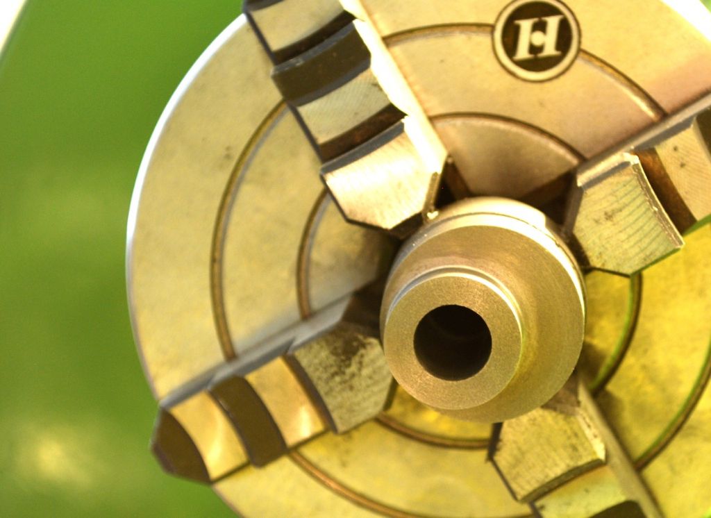

A little more progress with the Eccentric Sheave earlier..
The Eccentric Sheave after drilling, reaming and the boss faced to length.. Its ready for parting off now and then after the Eccentric Strap has been done it will get turned around and held by the 1/4" boss to finish it off - hopefully with the Strap available as a gauge..

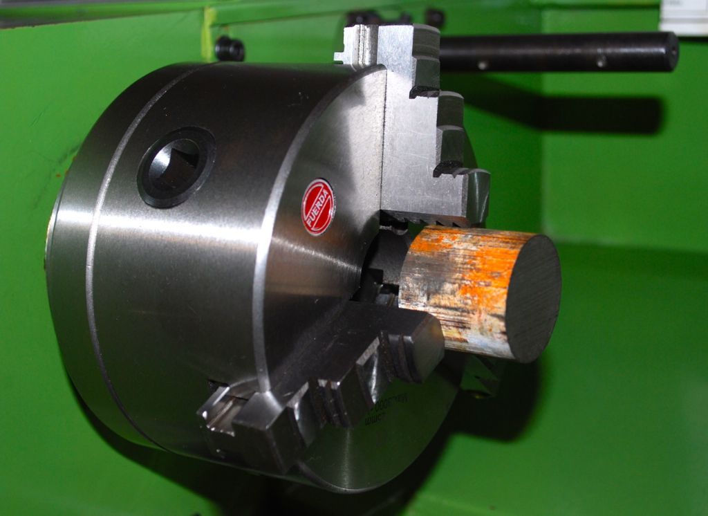

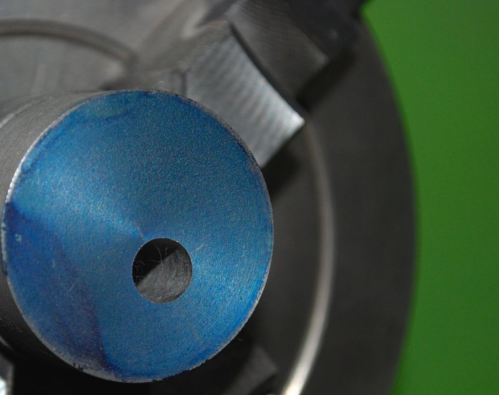

06/11/2015 14:20:13
Back going again today and a start on the eccentric sheave..
The Cast Iron bar supplied for the eccentric sheave - the first one I've had longer than specified in the stock list - by 1/8"..
First faced off and then the maximum OD turned to size in the 3 jaw chuck..

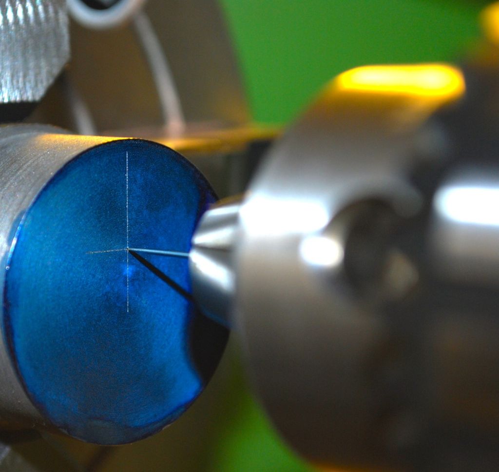

then the lathe's centre height used to mark a diameter followed by rotating through 90 degrees and the offset marked for the central bore. Having finished the main bearings on the Crankshaft with a reamer its convenient to be able to use again for each time something else is fitted to it..
I'd read somewhere about using a pin for centering for drilling so thought I would give it a try - it was ok but after managing to stab myself with it no less than 3 times I think I'll stick to the tailstock centre in future..
this is as far as I got earlier - through with a 7mm drill..
Once I've finished turning to size in this setup before turning around in the chuck I'll have a go at the eccentric strap so that I can use it as a gauge re. the internal groove etc...

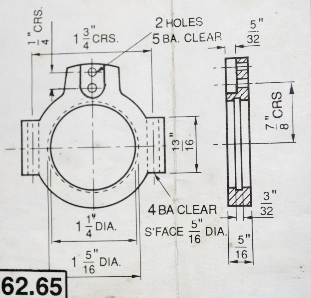

The Eccentric Strap Drawing.
