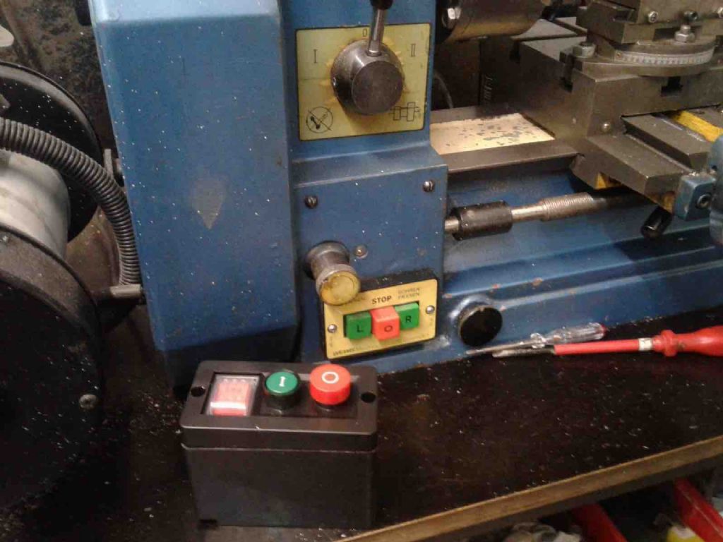

Hi, just received my new switch for my WEMAS lathe/mill which was a precursor of the Clarke CL500, same thing just way older and made in Germany...had to keep repairing failing switch so happy to find a replacement. Even happier to find this site that can help wiring it. The new switch is the same as yours in the photo...KEBU JD3..looks identical but came with a bunch or pre wiring (( see photos in my album)). So was doubling checking if the wiring diagram you posted did work for you... your post is from a few ago so thought it prudent to do the double check.... thanks in advance.....

thanks for all the prompt replies and updates !! will go ahead and give it a go... may take a bit of a creative repair as you can see..now where to put the new box.....anyone know why Clarke moved the switch and plonked it on the side ??..

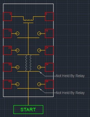

Hi I am looking for some help and advice. I have recently been given a Clark CL500M Mill & Lathe. However I am having problems with the electrical side and there seems to be a complete lack of information other than on this forum.
My current concern is with the Relay Start Switch. All the diagrams I have seen show the coil and 4 seperate contacts that are held closed by the coil. My coil (although looking like those above in ADY1's pictures) only holds contacts 13 & 14, 23 & 24 closed while the push start momenterily closes 33 & 34 and 43 & 44 on press.
I am leaning towards my relay is faulty, however I dont want to spend the £50 with clarke if it isnt the relay and I have a different fault causing my lathe not to run. I guess I am wondering if anyone on here can confirm that when there coil is energised that all the contacts are definatly held closed?
Thanks in Advance!
Adam Smith 1304/09/2019 20:02:08
5 forum posts
5 photos
