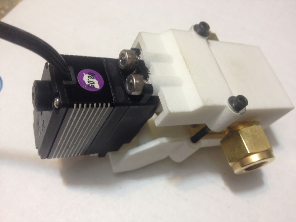

Carl Wilson 411/05/2015 01:26:09
avatar
670 forum posts
53 photos
Just something to inspire you. Hitec metal geared servo driving 3/8 swagelok 1/4 turn valve mounted in a 3d printed frame. Not mine, sadly...built by Rocket moonlighting.
