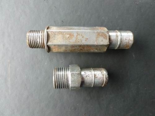

I want to replicate two radiator bypass hose connectors on a Suzuki Kettle I'm restoring in 303 stainless. They're 1/4" and 3/8" BSPT threads and I've never had to do taper threads before.
Do I just turn the bar parallel to the major thread diameters or should I be using the top slide to taper them up to the major diameter before using the die?. I have looked it up and know the sizes but I can't find any reference as to which is the best way to do things. The taper is 1 in 16 which would mean an angle of 1.5 ish degrees so would have to be a good guesstimate if I did it that way.

I've always cut tapered pipe threads with a die, whether with a die in the lathe under power or out by hand.
Pipefitters cut threads on millions of pipe ends around the world every day , and I've yet to see one do a cut taper thread in an engine lathe. Powered pipe threaders with dies, yes, engine lathes, no. JD

I don't see any problem die cutting a taper, I guess the only tricky bit is ensuring the taper die is not driven to deep or the threads will bottom out before they seal.
From my engineering handbook, the gauge plane and diameter at that plane that your aiming for are (for external threads)
for the 1/4"
Gauge plane 0.237" from end face
Major Diameter at that point 0.518"
for the 3/8"
Gauge plane 0.250" from end face
Major Diameter at that point 0.656"
I would guess the complete, incomplete and washout thread will dictate itself given the above depending on the OD of the pipe. For reference I've never heard of the taper being pre machined and I know the guys  I work with just cut straight on to parallel pipe! I'm certainly not suggesting its the right way to go about things, but it seems to work for them.

With the big hefty pipe threaders there is no need to put a taper on the pipe but if its a small split die then even 3/8BSP parallel needs quite a bit of elbow grease so cutting a small taper for BSPT will just make the job a bit especially on stainless.
Also worth remembering that the pipe threading kit tends to have a guide to keep the die head true which you won't get on a split die so again a bit of a taper will help things along.
This is what I sometimes use on the models especially exhaust pipes on the hit & miss ones, this is 3/8BSPT

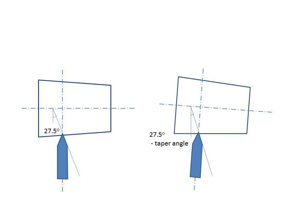

I'd have thought you could single point thread it between centres fairly easily with the tailstock set over?

The thread will then no longer be at right angles to the face of the material, it might not matter a lot but it will also distort the thread pitch angle as well

Can you not set the tool perpendicular to the axis of the taper rather than the surface of the taper?
I'd have thought that would result in the thread being cut right or an I missing something?

Setting the tool perpendicular to the tapered face as you suggest doesn't overcome the basic problem of the geometry of tool travel down the axis of the lathe across an angled surface.
Draw a sketch on paper to see what I mean

looking at some Machinerys publications, the flanks of tapered pipe threads are normal to the pipe axis not the taper with exception of gas fittings. Any way if you are making a couple of fittings for a radiator thread the form in relation to the pipe or the machined taper does not matter in practice, Use the die so that the tapered lead of the cutting teeth help produce a taper,then when getting close to size, and the thread is still tight in the mating hole,tighten up the die and only cut halfway down the thread so the first part fits and the rest is tight,and use loctite pipe thread sealer or boss white and hemp or ptfe tape. When I make steam fittings for full size I do use a taper turning attachment its just knowing when to adjust the thread by fiddling and when to do it correctly.

My point was to set the threading tool perpendicular to the taper axis and obviously change the setting on the the top-slide as well. I realize that cutting perpendicular to the taper face is wrong.
I think that the left hand picture would be as cut with a taper attachment and the second is with tailstock set-over (the whole lot is rotated so that the front face of the taper is parallel with the lathe bed) but I think that they may end up being practically identical. Having said that though I admit that the pitch length really would need to be made lightly longer in the second by a factor of sec(taper angle).

May I add what little I know to this discussion. Washout plugs on full size loco boilers have a tapered 11TPI thread. The threads on the plugs are lathe cut using a taper turning attachment and with the tool set as shown on the LH diagram by Jon Gibbs.

What you have said is slightly wrong, some plugs have the thread cut with the tool at 90 degrees to the centre line, others at 90 degrees to the taper, you do have to make sure you get the correct type, and depending on where they came from may not be 11tpi. See **LINK** for full details.
