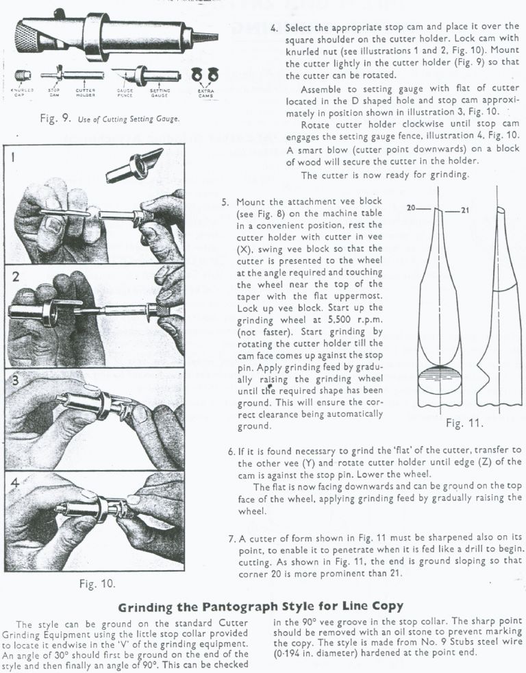

Roger, its without doubt an engraving cutter grinder. You should have a set of small shaped templates that fix to the cutter holder and allow you to create the correct cutting angles and tip size.If you use it then it may need a new white grit cup wheel. You can get diamond rubber bonded wheels as well.There should also be a small V shaped spanner for setting the cutters in the right position for grinding the angles.
It will grind the ends of small end mills up to about 6 mm dia. You will not get secondary relief though on the lip of the cutter only one angle. Again there should be templates for 2 flute end mils and 4 flute end mills.
It should run nice and quietly and smoothly, off hand grinding is not recommended. Use the jigs only as it is easy to pit the wheel.
I used one for 15 years and the engraving machine.

Phil P06/03/2015 22:53:17
851 forum posts
206 photos
No its definitely not a drill sharpener, the auctioneers dont know what it is and that is their best guess.
The previous answers are correct, it is for sharpening single lip engraving cutters with the correct angle and relief.
This is the cutter holder details.
I have a David Dowling one which is very similar in principle to the Taylor Hobson, but unless you are grinding engraving cutters it is of limited use, it is possible with a fair bit of work to modify it into a general cutter grinder of sorts.
Phil
