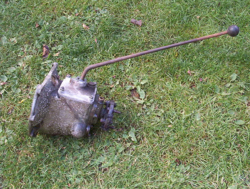

Neil Wyatt25/02/2015 10:14:05
avatar
19226 forum posts
749 photos
86 articles
What you need is an Austin 7 gearbox
This one is sold, unfortunately. One from a Reliant Robin would do (actually robin engines used to be a popular choice for 'marinising'.
www.7ca.co.uk/used_parts.htm
Gordon W25/02/2015 10:17:24
2011 forum posts
If you did go the gearbox way an old Ford Pop' SV is the easiest and strong. There are still plenty about .
