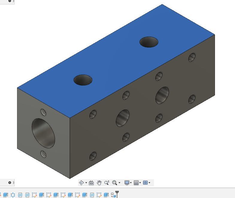

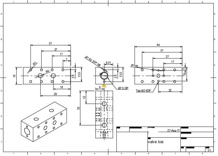

Sorry to jump in but i need help, im building my first engine (the potty mill engine) and the piston valve block shows no exhaust ports on the drawing. Is this correct ? Ive seen a few videos of them running with nothing to give me a clue unless there are drillings on the underside. Cheers Mark
SillyOldDuffer17/05/2020 11:51:37
10668 forum posts
2415 photos
Posted by Mark Braham on 17/05/2020 11:02:15:
.., im building my first engine (the potty mill engine) and the piston valve block shows no exhaust ports on the drawing. Is this correct ...
Hi Mark,
Do you mean this part?
The two holes on the blue face (which is normally underneath) are the exhaust ports. The two same sized holes on the right face feed the cylinder, and the input port is invisible on the other side.
