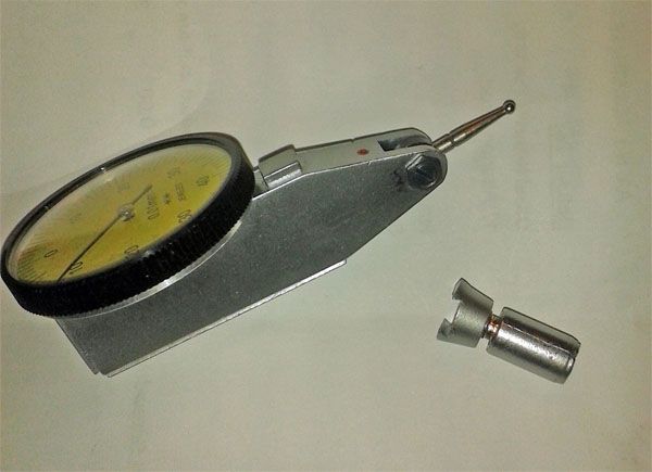

Hi Guys - next beginners question. Having found out what wigglers do - I'm now in the market to buy a metric dial test indicator to fit the "Offset Indicator Holder" wiggler. I've looked on ebay, etc. but not sure whether all (or any) of the dial indicators shown will attach to the "holder" (5mm diameter with adjacent 4mm through-hole). Any recommendations would be appreciated - are the indicators from Asia any good? Or should I just go to Chronos or RGT tools?

I bought one of the cheap Chinese important dial gauges from a here today gone tomorrow eBay vendor – it’s held by a dovetail that screws onto either a supplied 8 mm or 6 mm spigot.
I figured that as a beginner there was a good chance I might break the thing by accidently extending it further that it’s maximum range of travel, and that’s a lot easier to swallow if you’ve paid £15 as opposed to £70. It’s certainly proved be more accurate than my ability, but unfortunately yesterday the dovetail mount broke (i.e. fell apart!) making it useless. I have just ordered the marginally more expensive DTI gauge made by Silverline and from Amazon. Still relatively cheap, but hopefully more robust but still not a disaster if I break it. We shall see when it arrives …..
(Does anybody new where I can get a spare dovetail mount from ?)
