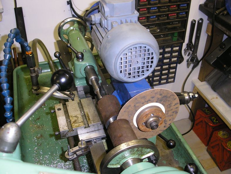

Phil P17/01/2015 12:52:00
851 forum posts
206 photos
I had similar issues when I rebuilt my Union grinder, another problem is the motor speed is not high enough for the smaller cup wheels. I decided to do my own thing and make a complete new variable speed head for mine.
The head also fits straight on to the Myford cross slide for odd cylindrical grinding jobs.
I also rigged up a head for doing four facet drill grinding, see photo's in album.
Phil

Phil P18/01/2015 19:29:01
851 forum posts
206 photos
This is what it looks like on the Myford doing a spot of crank journal grinding for a model petrol engine crank made from solid bar.
Phil
