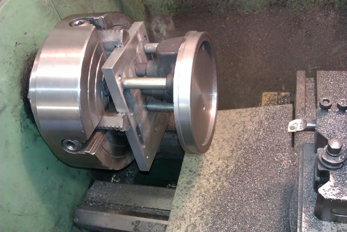

Neil, it depends on the size of your tool, this is a 4" dia recess 3/16" deep in an iron casting, no problem with a medium sized boring bar of 10mm dia, as KWIL says you don't need much overhang.

Agreed, that boring tool is effectively my 'end on' knife tool, my 10mm boring tool has an angled 1/8" toolbit for jobs like this and would take ages, while the bits that suit my boring head aren't particularly good angle for rapid metal removal either.
