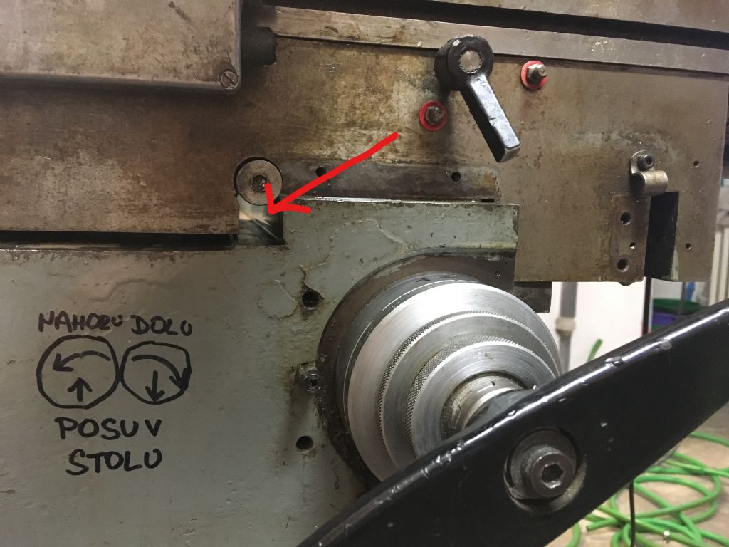

3.jpgHello all,
I just bought Beaver VBRP MK2. I am from Czech republic so this milling machine is not usual here. I just found out that gib key is missing. See the pictures please. I assume that I am only one owner this machine in the Czech Republic.
Could you please measure yours and write the dimensions to me? Some basic drawing will be the best. It would be really helpful.
Thank you

Mark Rand19/06/2018 23:30:07
1505 forum posts
56 photos
I'm afraid that I cannot help with dimensions for the gib. My machine is a VBRP MK1. All of the drawings I have are for the MK1 as well. Are there any adjusting screws on the left hand side of the saddle? If there are, the gib is parallel and you can measure the dimensions from one end and make a gib that will fit.
If there aren't, then it is a tapered gib and you will need to measure the width of the gap at both ends and make the gib to those dimensions.
If it is a parallel gib, you can make it to nearly the right size and adjust it with the screws. If it is a tapered gib, you really need to make it to the right taper, then scrape it to fit the ways.
If you can, make the gib from cast iron instead of steel. It causes less wear on the other parts of the machine (the original gibs were all cast iron)
Martin Zuzák20/06/2018 12:18:18
3 forum posts
6 photos
hank you for your reply.
There are not udjusting screws on the left side of saddle. There are only lock screws.
Yes, it is tapered gib. It seems that I will have to measure angle with sinus ruler, but I have to take down the saddle. Cast iron seems the best for it.
Do you know anyone who has drawings for MK2? I have original literature, but there are only basic information how to lubricate and etc…
I assume that Beaver factory doesn’t produce milling machine anymore. Right?

Peter_H21/06/2018 16:13:56
42 forum posts
20 photos
I can't remember the details of how that one is fitted, I think it is pushed in as far as necessary against the taper by the screw in Martins photo, and locked by several gib screws on the right of the casting. It is over ten years since I last stripped it though. I do have a spare however, which I just measured.
The gib has a single simple taper. It is rectangular with parallel sides 0.745ins (18.923mm) apart. The tapered sides are 0.496ins (12.598mm) at the narrow end and 0.658ins (16.713mm) at the wide end. The two parallel side are machined and the two tapered faces are ground and scraped. Hardened steel again IMO. There is a small groove about 30 thou wide and 30 thou deep across the top parallel face at the wide end, about 0.15ins in from the end. The gib is 241mm long overall.

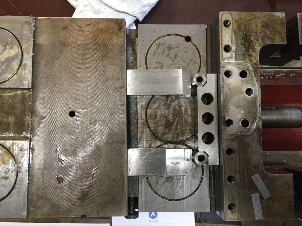

Martin Zuzák23/06/2018 09:34:04
3 forum posts
6 photos
Hello Peter and Mark,
Thank you for your help. I really appreciate it.
Dimensions what you measured are very similar what I measured. See picture how I measured angle tapered side. I used sinus ruler + (I dont know how to say in English, You will understand from the picture.)
The taper is 1 degree.
I will make drawing and show to you.
Peter_H23/06/2018 11:05:35
42 forum posts
20 photos
I would call it a Sine Bar. Yes, dimensions sounds very similar. The wear on the part I have would count for some discrepancy. Given that the original part was probably Imperial, and allowing for wear, my guess of original dimensions are :
length = 9.5ins = 241.3mm
parallel height = 0.75ins = 19.05mm
narrow part of taper = 0.5ins = 12.7mm
0.5 + (9.5*sin(1)) = 0.66579ins
which is consistent with 1 degree taper
