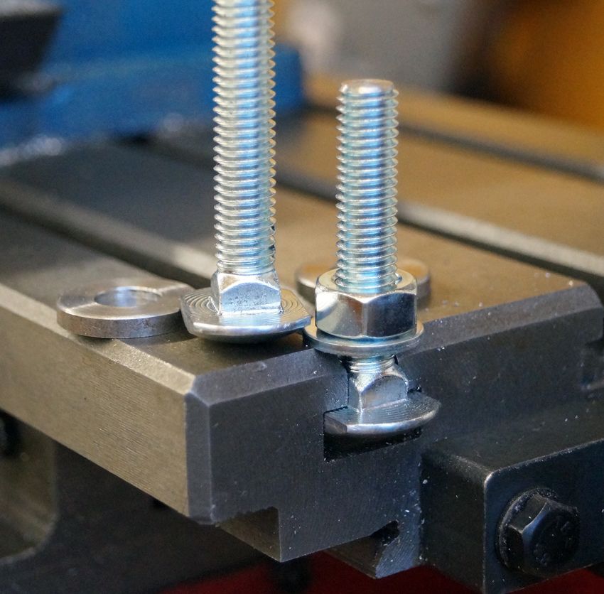

Noticed some M8 carriage bolts in my woodworking box, a quick measure up found the square section at the base of the thread fits the table tee slot. A couple of flats milled on the head and you have a couple of tee bolts. I know that carriage bolts come in numerous sizes, I think for the M8 there is about 30 sizes from 20mm up to 240mm. A selection of sizes could be useful for the clamping set, they only take 5 minutes to mill and they are also available in stainless.
Edited By Ron Laden on 23/10/2018 08:48:19
Russell Eberhardt23/10/2018 08:51:31
avatar
2785 forum posts
87 photos
Well done Ron. That's exactly what I did on my first mill in order to clamp some material to the table to make some proper T-nuts.
Russell

I think that’s how I made my first T nuts as well! smiley
