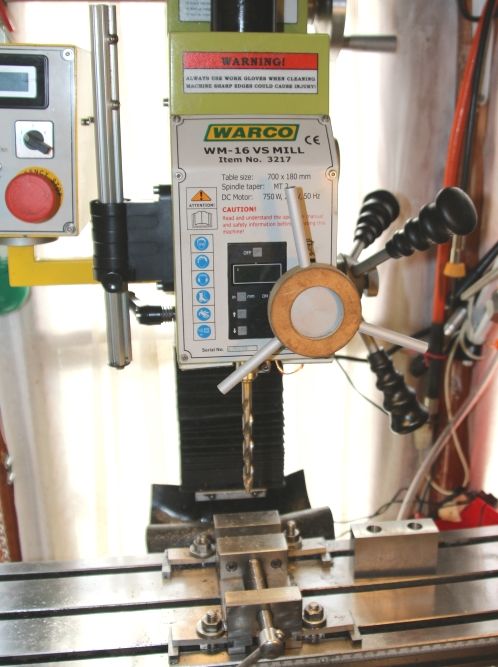

Rik Shaw20/09/2013 17:21:34
avatar
1494 forum posts
403 photos
I have found that the boring of deep holes on the WM16 to be an uncomfortabe task particularly as I suffer from bad cramps in my fingers. A slow two handed controlled feed with that little grey fine feed knob is not an enjoyable task.
Decided today that I would make the job easier by knocking up a very basic prototype aid in the form of a larger hand wheel to fit over the millers knob.
Hub is MDF bored out for a nice gripping fit on the knob and the ally tube handles are a tight push fit in their holes with added superglue.
If this turned out OK - and it has - I had intended remaking it with an ally hub, a proper job, but as this works OK I'll wait until it falls apart (I have a feeling it won't.
Rik

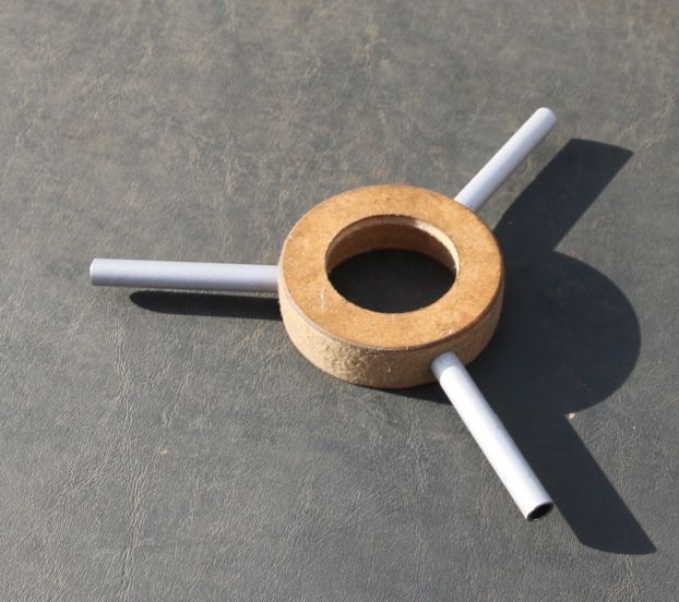

Thor 🇳🇴21/09/2013 05:16:51
avatar
1766 forum posts
46 photos
Hi Rik,
nice handwheel, using the fine feed knob to move the quill down is not easy on my old fingers either. I usually use the coarse feed handles though.
Thor
Stub Mandrel21/09/2013 10:33:41
avatar
4318 forum posts
291 photos
1 articles
On my X2, which has a smilar arrangement, I find that the length of the main capstan arms is so great, that I can adjust the head position to the limits of my DRO, however. it is very easy to overshoot.
I had planned to put a handle on the fine feed knob, but I might copy your design instead.

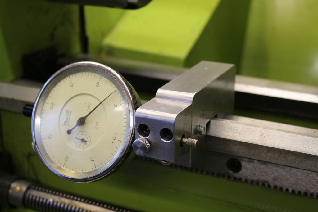

Rik Shaw30/10/2013 16:07:41
avatar
1494 forum posts
403 photos
bed stop.jpgNovel way of using a depth gauge George, let us know how you get on with it.
I have made an improvement to your bed stop design. The "piggy backed" piece of ally is secured by 2x 5mm capheads.  I can now use a DTI without removing the original threaded stop.
Edited By Rik Shaw on 30/10/2013 16:14:26
Edited By Rik Shaw on 30/10/2013 16:15:07
mechman4830/10/2013 17:21:42
avatar
2947 forum posts
468 photos
I like it, thanks for the update, much prefer to see nice large digi' numbers though what with my eyes and all, nice mod never the less, will keep in the memory bank... memory bank ! ... where's that, & what interest rate are they paying?... ho hum, retiree's humour face 22.
George
Thor 🇳🇴30/10/2013 17:30:18
avatar
1766 forum posts
46 photos
Hi Rik,
I like your "piggy backed" bed stop solution, it's on my "to do" list.
Thor
