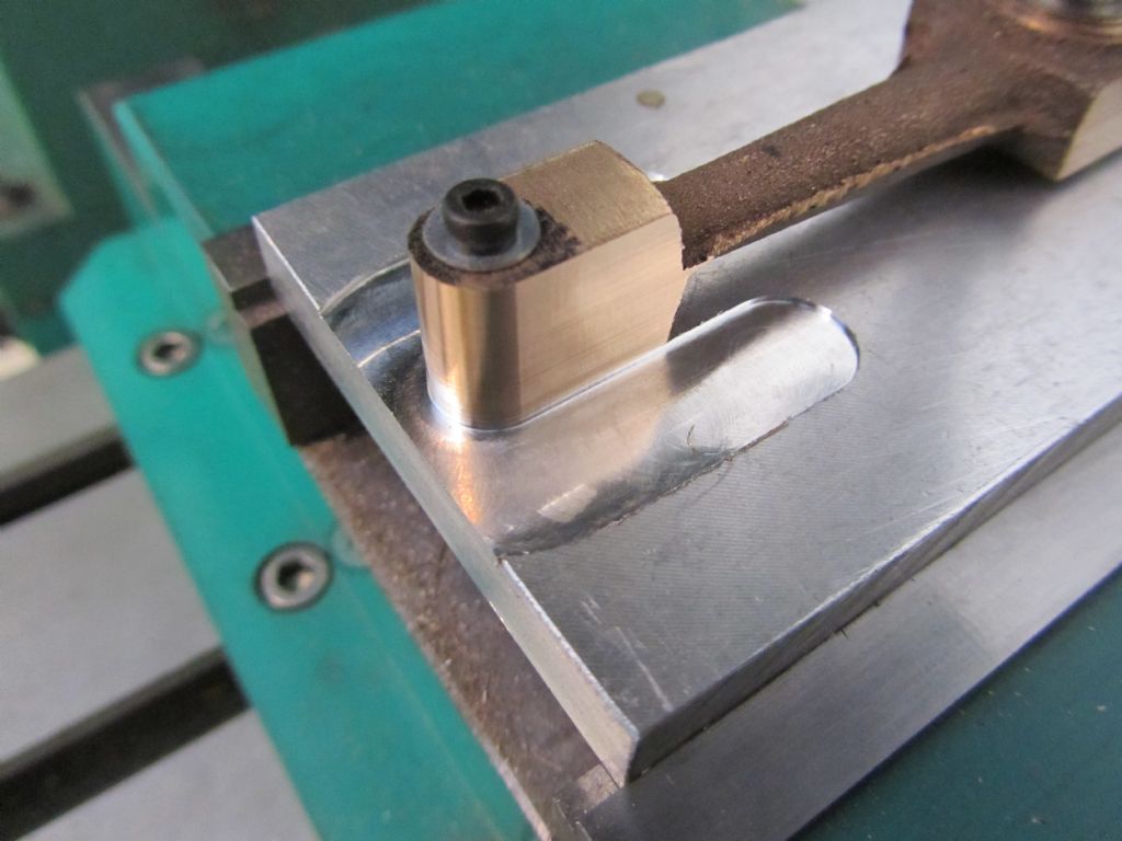

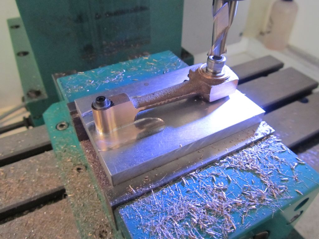

I took a handful of 10mm slot cutters to Harrogate and John kindly sharpened them in return for a donation and lots of questions!
I have used one of the cutters for the first time tonight and I cant complain! All these cutters where telling me they werent happy the last time they were used so were put to one side for sharpening or more likely the bin.

Posted by Michael Checkley on 29/05/2015 20:39:59:
Michael would it be possible to say what depth of cut and proportion of the cutter was used on this part.
To my eye and looking at the length of the swarf the finish we can see on the part was a full depth cut possibly climb cut as is common on CNC machines so little of the resharpened tip would have come into play. The only part that the tip may have affected is where the tool ran out into the ali plate where there is a burr that can be seen on the first photo on the nearest edge where a climb cut would not have been applied.
Just curious as to which part of the cutter has actually done the work.

Hi Jason, it's a valid point which I think I can answer with another photo. Out flying at the moment and can't upload from my mobile...
