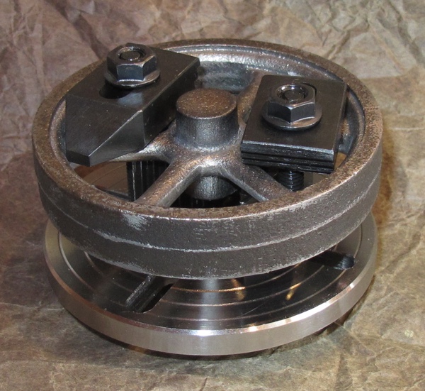

I have sorted out my set up to machine the small 3" flywheel for the Stuart S50. It consists of a couple of spacing blocks to hold the flywheel away from the faceplate, but the smallest clamps that I have are still ungainly....
Stuart S50 flywheel
So I am now thinking of making something a little more manageable.

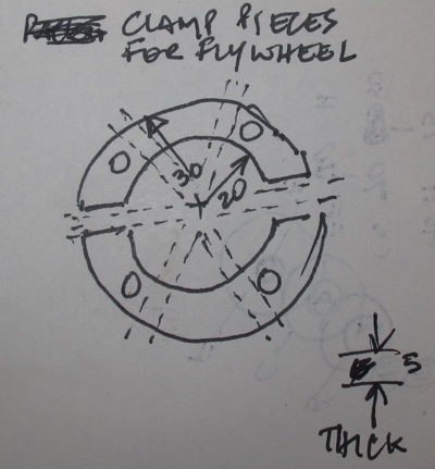

I intend to machine a short length of 32mm steel tube (from the scrap box) to act as a spacer, and then ideally a couple of crescent shaped pieces to clamp onto the spokes. If each piece has an outer radius of 30mm and an inner radius of 20mm, leaving a 10mm wide crescent then that would leave space at the centre to machine the boss at the same time.
The "fun part" will be trying to figure out how to make the two crescent shaped peices blush

The easiest spacer is a piece of MDF or ply with a rough hole in it to clear the hub and two clearance holes for your bolts. You can machine teh whole face as the tool can run into the MDF. This is the same thing on a larger flywheel that had a lot of bosses on the spokes and being 5 spoke not able to use 3 or 4 jaw chuck.
Crescent shaped clamp plates are also a bit OTT just take two bits of flat bar and drill a clearance hole in them,if you must cut the bar at say 30deg angle.
With a small stuart flywheel you may be able to grip by the inside of the rim depending on the size of your 3- jaw chuck, cut to within 0.5mm of the chuck jaws (improvised bed stop helps) and then clean up whats left when you do the other side.

The potential for the clamps as shown to twist is enormous as the pressure points on the spokes are potentially offset from the line joining the two clamping holes. It would work better as a single ring.
regards Martin
That's a better idea. Thanks.
What I would like to do is have one clamping piece which will also allow me get a tool in to face the boss and also turn down its diameter, as well as enabling me to machine the outer rim of the flywheel.
How to make that single ring (60mm diameter and with a hole 40mm) and find the right material to do it?

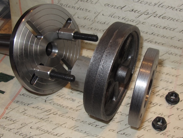

Rod Neep21/04/2016 12:38:15
avatar
59 forum posts

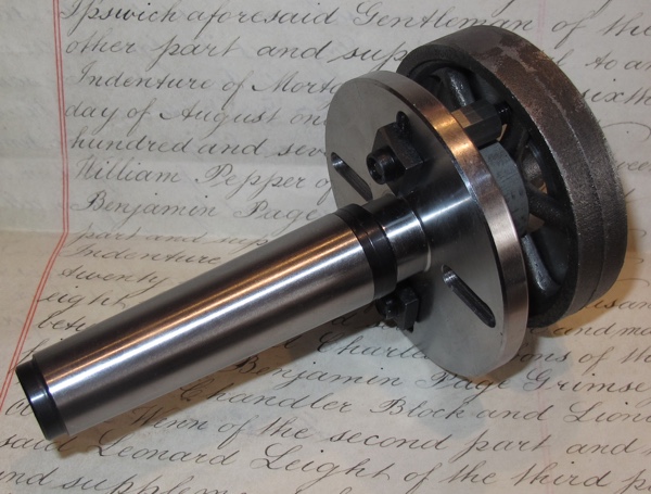

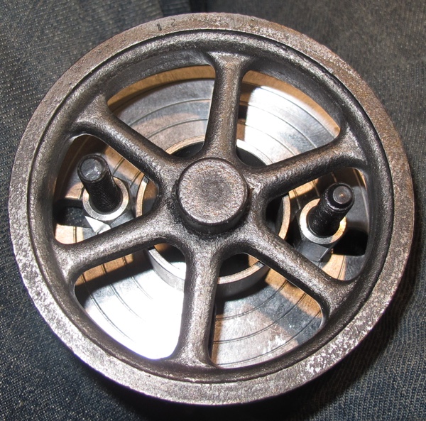

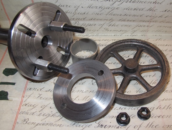

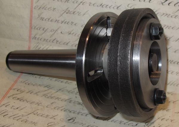

I have come a long way on from my first thoughts.
One solution to setting up to machine a small (3 inch) cast flywheel.
The problem being is that most face plates are too large and are unable to hold such a small item.
What I have here is a Unimat faceplate attached to a 3MT (12mm Emco thread) arbour, so that it will fit into my lathe. That's the face plate taken care of....
And next, the clamping of the flywheel:
I made a support "spacer" from 32mm diameter stainless steel tube (because I had some lying around). That supports all 6 spokes. A "disc" clamping plate is a little smaller than the inner rim of the flywheel to spread the load over all of the flywheel spokes. and allows a little "tapping room" to get the flywheel centred. The round clamping plate has a large hole at the centre so that I can get in to machine the boss of the flywheel.
The steel tube (supporting the spokes) spaces the flywheel away from the faceplate to facilitate machining the back outer edge.
Rod
Edited By Rod Neep on 21/04/2016 12:38:51
Brian John21/04/2016 12:45:29
1487 forum posts
582 photos
That looks very interesting ; thank you for posting those photos. I have just finished machining a cast iron flywheel of the same size but I used the mandrel method. I could not get a mirror finish with my cutting tools so I had to spend two hours polishing it up with 400 grit wet and dry. What tools will you use to machine the flywheel...do you have special cutting tools for cast iron ?
