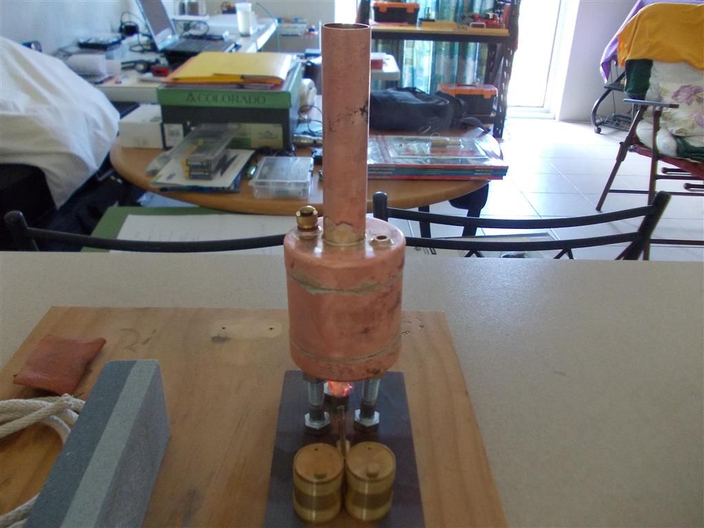

Brian John10/12/2014 03:04:01
1487 forum posts
582 photos
I went to the scrap yard this morning and a found piece of copper tube which fitted nicely over the brass tube. I also found some copper tube the exact same size as the brass chimney so next time I build one of these I will use a full copper chimney right through which is what Midwest should have done in the first place. I decided to remove the damaged part of the brass chimney ; I think this was a mistake as it would have helped keep everything upright by leaving the full chimney intact.
As you can see from the photos below, after the solder had hardened the chimney is not perpendicular...very frustrating as it was perfectly straight when I started soldering. I suspect that the top of the boiler may have changed shape and buckled a bit or the copper sleeve was not as good a fit as it could have been.
After putting it in the pickle for one hour a decided to give it a quick test to see if it actually produces steam as there would be no point putting the insulation and wooden lagging on if there was a leak somewhere. In the photos below it is not actually under pressure as I left the fitting out for the steam outlet but the water does boil and steam comes out of the hole so something should happen when I connect it up.
I really must buy another one of these and do it properly next time ; both the boiler and the engine could have been much better. I am not sure if it worth trying to remove the copper sleeve as that would require a lot of heat and it may ruin all the other solder joints.
NOTE : It does not look too bad in the photos but it is actually quite bad......seriously thinking of grabbing the blow torch and trying to remove it !

Neil Wyatt10/12/2014 11:18:31
avatar
19226 forum posts
749 photos
86 articles
Brian,
The copper should now be in a very soft state, A bit of broom handle down the chimney and very gentle, controlled pressure should see the chimney upright. Just be very careful not to dent or crease the boiler - you will need to find a way of holding it that gently spreads the load.

Brian John11/12/2014 02:36:27
1487 forum posts
582 photos
Thank you for that suggestion ; it worked well. I had a piece of wooden dowel which was a perfect fit and the chimney is now straight. So I decided to fire it up and see if it runs the 3BIM engine from PM Research. Nothing much happened for a while : there was a bit of steam and some water but that's is all. Then I noticed the boiler was turning a golden brass colour. I did not like the look of this so I removed the flame to see what the problem was. In all the excitement I had forgotten to fill the boiler with water !

Brian John12/12/2014 02:32:42
1487 forum posts
582 photos
I dropped it in the pickle and the copper colour was restored ! I ran the twin cylinder 7BIM engine today and all went well. I did not forget to add water and only filled the boiler about 3/4 full. This engine really needs a slightly bigger boiler but it did turn over and ran quite well.

Brian, the change in colour was just the copper starting to oxidise, as you have found the acid soon takes it off.
One thing that will reduce the amount of water and condensate being spat out of the engine would be to have your rubber tube sloping back DOWN to the boiler, just stand the engine on something to raise it up a bit.
