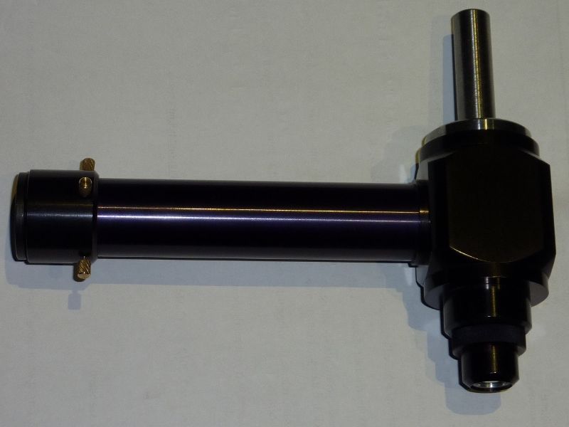

I finally finished the Centering Microscope.
To protect the threads I used electrical tape wrapped tightly onto both internal and external threads, it was quite tricky and not quite 100% effective, as the acid effected the adhesive and ingressed under the tape, especially the internal threads where I could not apply as much pressure as the external threads. In spite of this I finished up without any problems with mating threads being too tight.

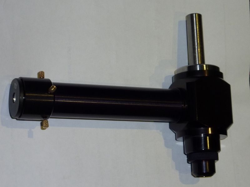

To colour the anodising I used "Parker" black ink 1:1 with distilled water. With the exception of the tube section all the aluminium parts were made from the same piece of stock bar, and all took on the same colour and shade, however the tube finished up with a slight blue tinge, I'm assuming this is due to the difference in grade of aluminium as it was quite difficult to machine compared to the bar stock. This can be seen quite clearly in the second photo.
As this is really my first attempt at doing a finish component and not just a test piece, I'm very pleased with how this has turned out.
Martin

Congratulations Martin your microscope is a credit to you.

Martin,
You are quite correct that the "colour" changes with the grade of the aluminium, if you want it exactly the same, it must be the same material.
Commercial anodisers have this problem as well.
