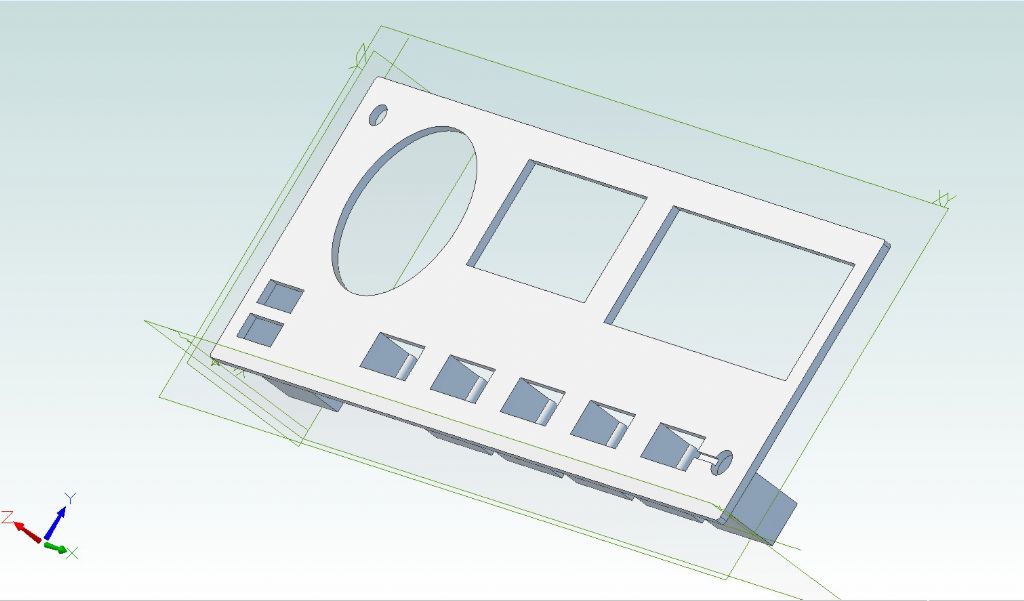

Neil Wyatt04/11/2018 09:59:59
avatar
19226 forum posts
749 photos
86 articles
You can switch the 3D view between perspective and orthographic, but then I had a shock when this part was rendered as getting bigger as it went 'into' the screen!
I checked and the setting is orthographic too!
It's actually an optical illusion! Calipers on the screen reveal the panel is drawn the same length at each end, despite appearances.
