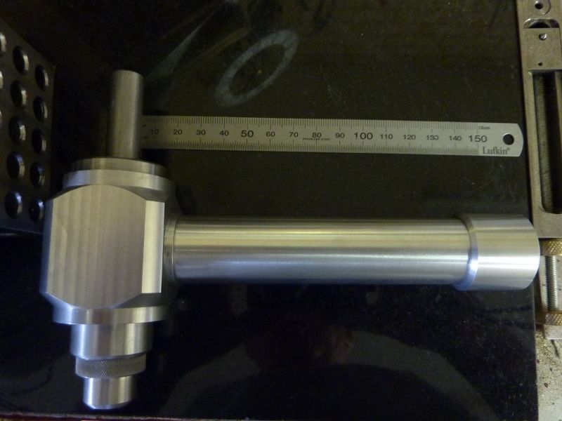

Is it feasible to anodise the assembled unit and disassemble it after to fit the lens etc?
For those who are not familiar with the microscope see below picture.p1010822 (800x600).jpg

Martin, every part should be anodised seperately at the same time in the bath. If its anodised as one item the internal threads and inserts will not get anodised.
The tubular parts will be put on the jig with internal clips so marks will not show on the outside.
The anodising figure for what you want doing should be AA5 - AA10, this will be perfectly adequate for the use it will be put to.

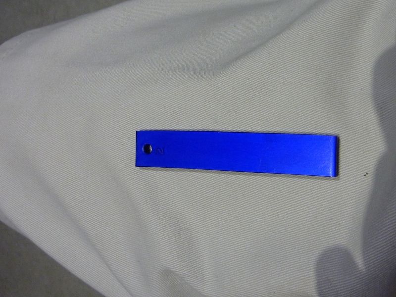

My second attempt at anodising 12x66x3mm strip unknown grade (I assume it came from aluminium sheet used in small aluminium boat manufacturing).
The first one I did, I had problems with maintaining a suitable connection, I used titanium strips milled from sheeting, I simply bent the strip into a hook and dangled it into the acid bath, in turn clamping the other end of the strip to an aluminium angle which spanned the plastic container. This all proved to be too flexible and failed to provide a suitable connection.
The second attempt I squeezed the hook tight with pliers (see the marks above the hole) this worked immediately and bubbles started to appear as soon as switched the power on.
The colour was "Parker" blue diluted 1:1 with distilled water, immersed for only 5 mins then sealed over simmering distilled water for a further 5mins then left in the water for a further 15mins.
Futher improvements to the fastening will need to be made prior to my next episode, any suggestion to this would be greatly appreciated.

Congratulations Martin, that looks very good - nothing like some success to lift the spirits - you're certainly on the right road now.yesyes
Re the fastening of the part to the hanger - so far all I have done is taper the end of the hangers - a very slow taper that is - and just gently pushed these into suitable holes in the component to give a tightish fit. This has proved more than sufficient on such parts that have a hole. On the cylinder heads I bent the hanger back on itself in a 'U' to a spring fit inside the cylinder head. This does leave very slight noticeable marks at the contact points once coloured but as these are hidden on assembly they are of no concern. By just hanging the part lightly on the hanger the surface will anodise beneath the point of contact reducing the electrical condutivity as it does so.
Writing inks have certainly given me the best results so far and I have since bought some other but as yet untried colours. Tha's certainly a lovely blue.
I still think you could protect the male thread from anodising by wrapping with PTFE tape - now you are set up why not try that on a test piece - I would be reluctant to 'lap' the thread by bringing the two parts together - they may bind irretrievably - but lapping the male with a small piece of hard wood with the paste embedded into the end grain works well if used like a thread chaser - letting the thread gradually form itself into the grain as it runs down the thread. I have used this method on many occasions when a chaser isn't available to polish a thread for that final fit.
Hope this is of use - Ramon

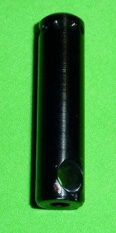

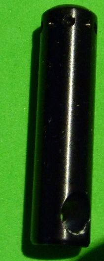

I have just successfully anodised a small part using Parker Black Ink.
Approximately 20 mins. in acid bath (20%) @ 15v amps @ around 0.4-0.5
10 mins in 1:1 ink/distilled water.
5 mins. in steam and a further 10-15 mins in simmering distilled water.
I also had success on another part using thread tape to protect the thread from anodising.
The following pictures are an indication of the colour, in reality the finish is much better than the photo's show.

Nice work Martin, very nice Black.
For some reason black ano dye is more expensive than the rest - good to hear the ink works as well as the other colours - all I need to do now is find a nice bright green.
Pleased to hear the thread tape idea worked too.
Your time is much shorter too - so far I've run for 40 mins but will try reducing it next time.
Did you get any leaching of colour after the steam when simmering?
Regards - Ramon
