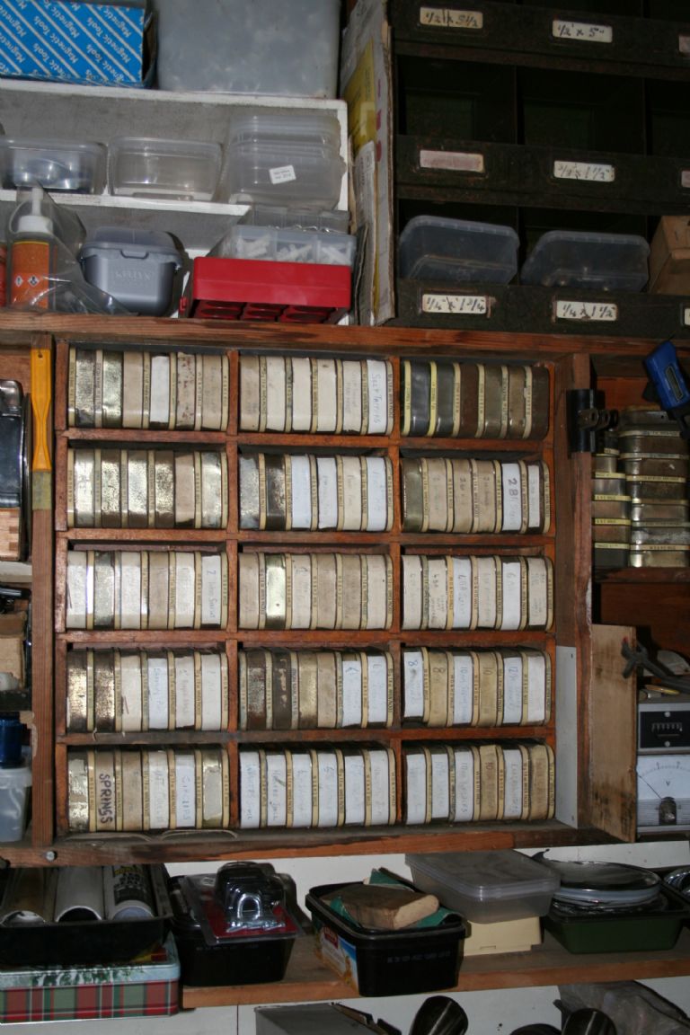

My Dad smoked Golden Virginia, it came in very useful tins. I made a small chest of draws with six tins in metalwork when I was at school, I still keep Dremel grinding wheels etc in. They are great tins, ideal for allsorts as the lid has a seal, ideal for engineers blue!

I always used to scrounge the tins and still use them 40 years on.
At the same time discovered they fitted perfectly into an internal mail letter rack that was being thrown out. So cut down the letter rack to fit my bench. Very handy for those small items.Two ounce tins.jpg
