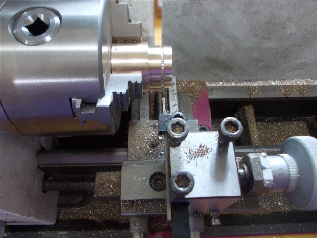

I tried to cut out some 25mm discs for the large crank today. Everything went well until the parting off. I had problems parting off the smaller 19mm cranks but that was only because of the end shape which had a slight dome in it. This was later rectified by taking a facing cut when the disc was mounted in the lathe (I will try a wax chuck next time). The parting off procedure went reasonably well for the smaller discs.
But today I am having problems cutting through the 25mm diameter workpiece. It does not matter how slow I feed it in or what chuck speed I use, the blade type tool keeps digging in. I have read that some people turn the tool upside down and run the lathe in reverse. How does this help...if it helps at all ?
The brass work piece is 33mm long : half in the chuck and the other half protruding.
NOTE : carriage and top slide are locked in place.
Bodge : that is what I intend to do, set the work piece up close to the chuck when drilling. I was thinking of taking it back but they are probably all the same.

Brian - an inverted cutting tool running in reverse cannot dig in, the deflection is away from the work, also swarf drops away from the cutting edge due to gravity so less chance of swarf jamming cutter.
I have used this method and can testify to it's worth, especially with hss
I also have a carbide tip parting tool (replaceable tip type) which has proved to be the best parting tool ever.
I use this in the conventional way, not inverted. smiley

Beside the upside down blade and running in reverse, try drilling a centre hole in the end of the job and keep the tailstock centre in place until you get down to the last little bit before the cut is finished.
I wouldn't worry too much about wobble at the end of the stroke of your drill press. What's important is the wobble in the first inch or so of movement. This is the area you will use for 90 per cent of model work. You can also drill and tap the drill housing for a couple of brass grub screws, or even slit it with a hacksaw and install a pinch bolt, but you already have one machine tool that needs fettling...
If you bought the drill press from supercheap or Bunnings, I think both will let your return it for a refund if it is "not fit for purpose". It might be worth looking at the Kinchrome drill presses at Allied Bearings but I'd expect they're more expensive at $179 at the moment. They all look the same, made from the same castings but machined and assembled by different companies. Kincrome at least has some kind of quality control checks before they put their name on it. Most of their stuff is reasonable quality, not Snap-On or Stahlwille quality but good enough for home use.
Your best shot for making future 'wax chucks" might be some ally bar a bit larger than the diameter of your crank disc, then turn a recess in the face to match the disc diameter and glue the disc in the recess with super glue or Loctite. Or, even more economical on material, and making parting easier for yourself, turn the outside diameter of the brass crank disc to size then drill and ream the hole down the middle. Then part it off. Then take a piece of scrap bar, eg 16mm, and turn a short section down to fit neatly in the reamed hole. Put the disc on the newly turned spigot and superglue/Loctite it in place.

Posted by Brian John on 20/10/2015 14:14:05:
I thought somebody had instructed me earlier never to part off when turning between centres....was this incorrect ?
No ... not incorrect, but:
There is a small, but very significant difference between 'turning a deep groove' and 'parting off'
You can safely use tailstock support for the grooving ... but remove it for the parting.

Brian. there is no real problem with putting the tailstock centre into a drilled hole for added support it does not have to be just a centre drilled hole
I sometimes make parting cuts with tailstock support but REMOVE the support before the part is completely free, usually finishing with a saw.
Good to hear that using the correct drill before reaming is working for you.
I think on such a small machine it will be hard to fit an indexable parting tool and the wider cut they produce could cause more problems than it will solve.
Try grinding your parting tool to have less or even no toprake for brass, looks like you are using the same toprake you had for alumining.

The reason a rear upsidedown parting tool works 'better' is that on old lathes there is often nothing to stop the rear of the saddle lifting up, or it is not properly adjusted to prevent it by at least a few thou. Thus as the tool digs in the direction of force is lifting the tool away. So the method does not work so well on many modern or new lathes but people still adhere to the mantra.......... When that doesn't work they get seduced by the carbide insert tool cult........

Hi Brian - I got the parting tool from SPJ tools( see advert to right ) don't know if they still do it as it does not appear to be listed on their web site. You could try RDG tools also.
I have used a standard parting off tool both normally and inverted, can't say one was any better than the other.
Brass and aluminium no problem, steel altogether more difficult - best advice is keep tool overhang to a minimum, keep the infeed as constant as possible to keep the tool working ( be brave and let it cut).
Carbide insert tool, best I have ever used, just used it to part off nine cuts of 12 mm square stainless steel, yes! Interrupted cuts and all, with no protest from the insert.
I am a convert, but will probably still use HSS for alu and brass.

If you are still having trouble with the parting tool chattering and cutting crooked, it could be a matter of the cross slide not set up right/loose.too,.

Parting off problem solved : when I was getting a dome shape on the 19mm discs somebody asked if there was an angle on the parting off tool. There was an angle so I had filed it off flat. But it would appear that an edge is needed so I used the bench grinder (first use of this tool ! ) to restore an angle. The original angle had the leading edge on the left but I put the leading edge on the right to eliminate the dome effect on the disc. This seemed to work well and the brass peeled off nicely. I managed to successfully part off three 25mm discs today. I put the discs in the chuck supported by washers to take a facing cut and clean it up, taking it back to the required 4mm thickness...well close to it !
I will make a few more 19mm and 25mm discs tomorrow. I am not confident of cutting out the cranks and I think I will be going through a few before I get it right. I need to plan this operation better as I cannot do it by eye.
 I was not initially parting off with the work piece supported at the back by washers as per the photo but after cutting two discs there was not enough brass left so  I decided to see if I could cut a third by using the washers...getting a bit cocky now !
I did not have any luck supporting with the tailstock as it left a chamfer on the inside of the hole even though I had only screwed it in lightly (or thought I did). Once I put an edge on the parting tool then there was no need for it anyway.

NOTE : I did try using the tool upside down and running the lathe in reverse but the blade of the tool kept getting pushed in ! No matter what I did or how tightly I clamped down on the blade it would not hold so I gave up on this method. Good thing anyway because it made me look for a correct solution to the problem. I am still not sure why the blade would not hold when the tool was upside down ?

Posted by Brian John on 21/10/2015 08:55:27:
Brian,
Apologies if I am missing a trick, but I have to ask ... If you just inverted the tool: Where did that put the cutting edge in relation to centre height ?
Brian John21/10/2015 14:02:25
1487 forum posts
582 photos
Far too low... I realise that now. I have just checked and even if I had used plenty of packing to raise the tool to its maximum height on my lathe then it would have still been about 2mm below centre height. It might be worth trying as an experiment tomorrow to see if it actually does cut any better when inverted.
